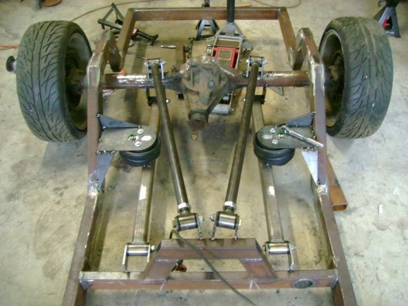

Edited: 6/28/2009 4:08:44 PM by roadgrateri dont know how to post pics but here you gohttp://i66.photobucket.com/albums/h278/kickstand5/DSC04827.jpg http://i66.photobucket.com/albums/h278/kickstand5/DSC04828.jpg http://i66.photobucket.com/albums/h278/kickstand5/DSC04829.jpg http://i66.photobucket.com/albums/h278/kickstand5/DSC04830.jpg http://i66.photobucket.com/albums/h278/kickstand5/DSC04831.jpg

I would say lower your front lower mounts, to were the bottom of the mounting tab is just above the bottom of that crossmember. The upper mounts need to be lower also. Remember, if you are looking at your link bars from the side, and where to extend them out, you would want them to intersect around the front bumper. Another thing I would change, is put the bag mounts on the bars, instead of offset to the side. I've seen some scary stuff happen with mounting them like like(Including my own truck).

I would also pull your bag mount in closer to the frame. You have a lot of pressure on the inside of that bag mount, it's acting like a lever, the longer the lever, the more force that is applied. I don't mean to pick apart your build, just trying to share my experiences with you. Post some more pics as you get it further along!

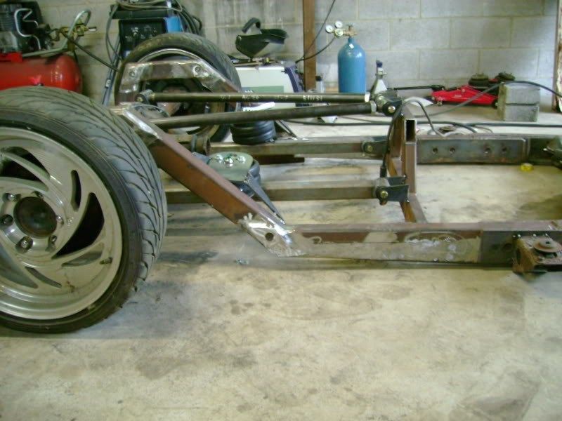

got a new layout of the 4-link check it out http://s66.photobucket.com/albums/h278/kickstand5/?action=view&current=DSC04840.jpg http://s66.photobucket.com/albums/h278/kickstand5/?action=view&current=DSC04841.jpg http://s66.photobucket.com/albums/h278/kickstand5/?action=view&current=DSC04839.jpg

Better 4-link layout, but ur going to experience alot of flex out of those bottom bars with the bags mounted on the side

definetly a better layout but in the first pic of the new set up it looks to be set at ride height ????  from the pic it looks like your instant center is actually behind the vehicle at ride height which may cause some odd handling characteristics.
