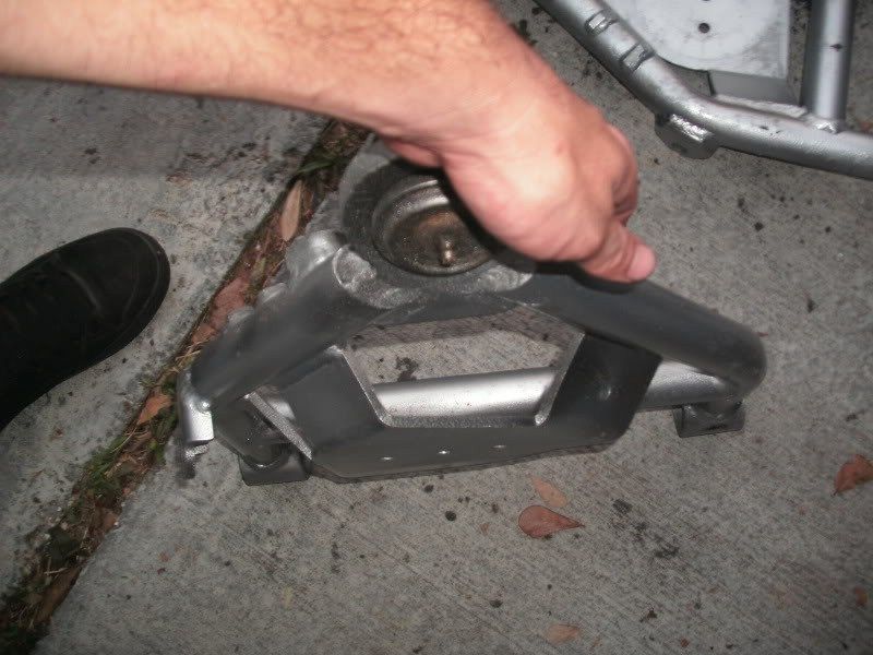

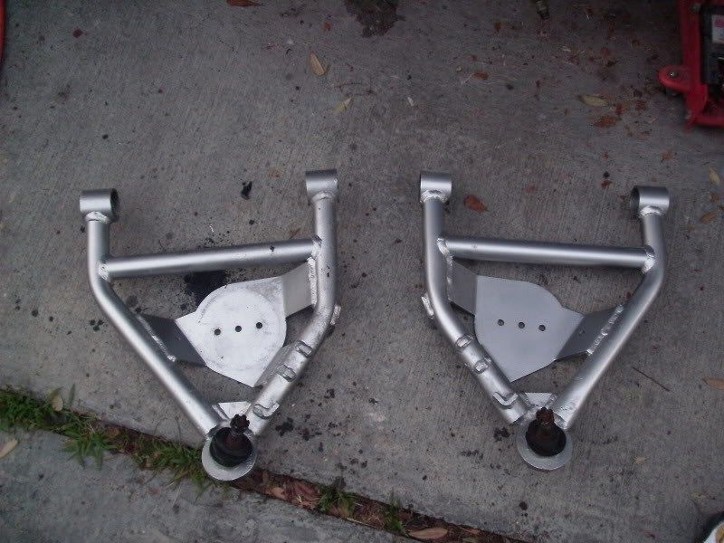

well I finally got pics of the arms. i bought a set of stock replacement poly bushings, and they had to be cut down an 1/8" to fit. luckily my dad is a machinist, so he just threw them on the lathe and turned them down for me. but does anyone know what arms these are?
