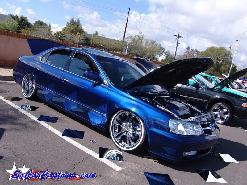

so i bought an 03 acura tl type s..bout a year ago..bought it to bag it..havent done shit to it but drove it.. well i stacked sum cash (finally) and wanna know sum opinions on sum shit.. whats a good sytem to put in it.. i want fbss..and air struts.. dont wanna spend hella cash for a full kit.. coolcars.org got sum nice full kits..im think n the 98-02 accord kit is the same as an 03 acura tl... throw sum opinions at me.. and i def aint gonna juice it.. its sick as fuck when they juiced.. but im not gonna do it.. im not hate n.. just wanna bag it.. thats all.. thanks in advance.

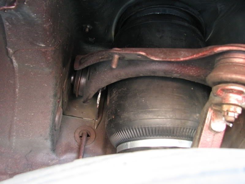

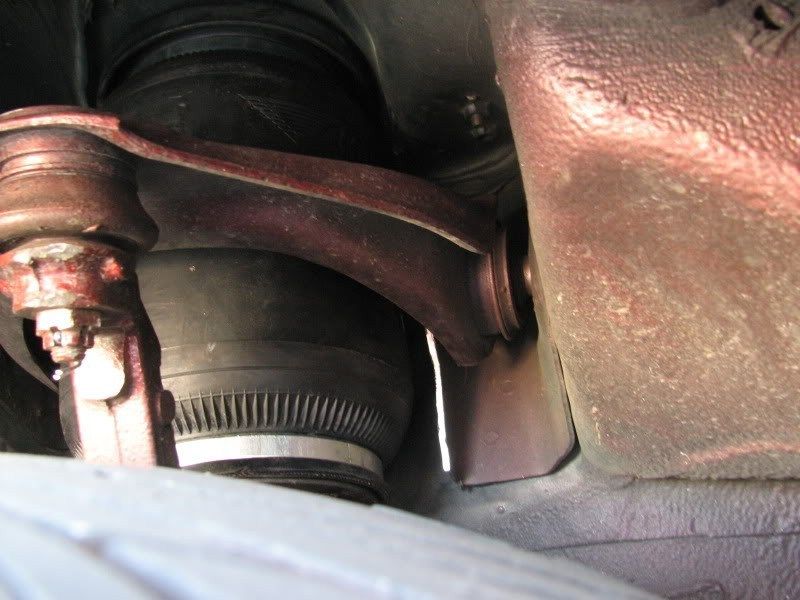

Your options are cans, air struts, or get with a fabricator that can really make real bag mounts.  I would go with the last option since cans: little lift, little drop (thanks to their size), horrible ride and require rebuilding quite often. Air struts:  I hear ride good, but the drop is questionable, they are expensive, and I've heard issues with the air sleeves detaching from the strut itself and rubbing.  Same with UAS bags, they'll rub on the spindle and then won't sit low since they need a strut in there and wherever that bottoms out - that's it. A good fabricator get get some bags in there off the control arm and make some nice mounts in the rear and will do the trick, but will require cutting.   If you've got $4500 burning a hole in your pocket you could do air runner which makes a real nice system...but I'm a hydraulic guy, so take my advice with a grain of salt.
