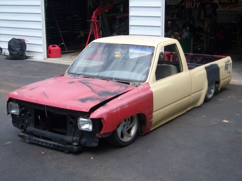

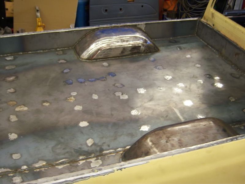

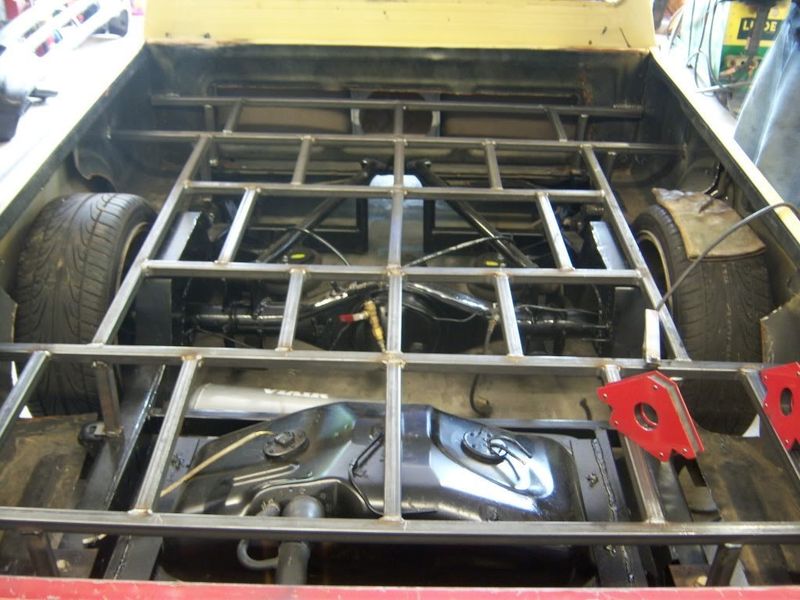

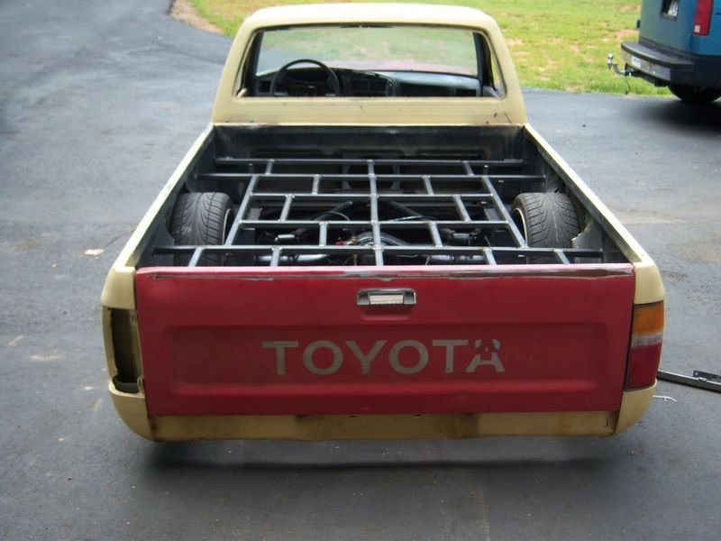

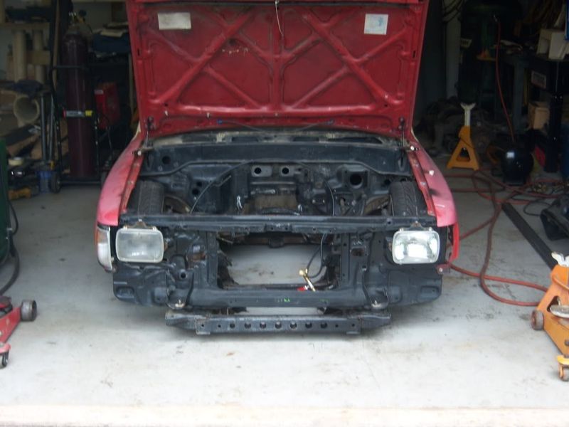

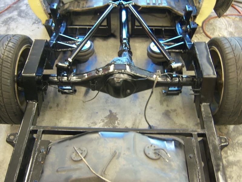

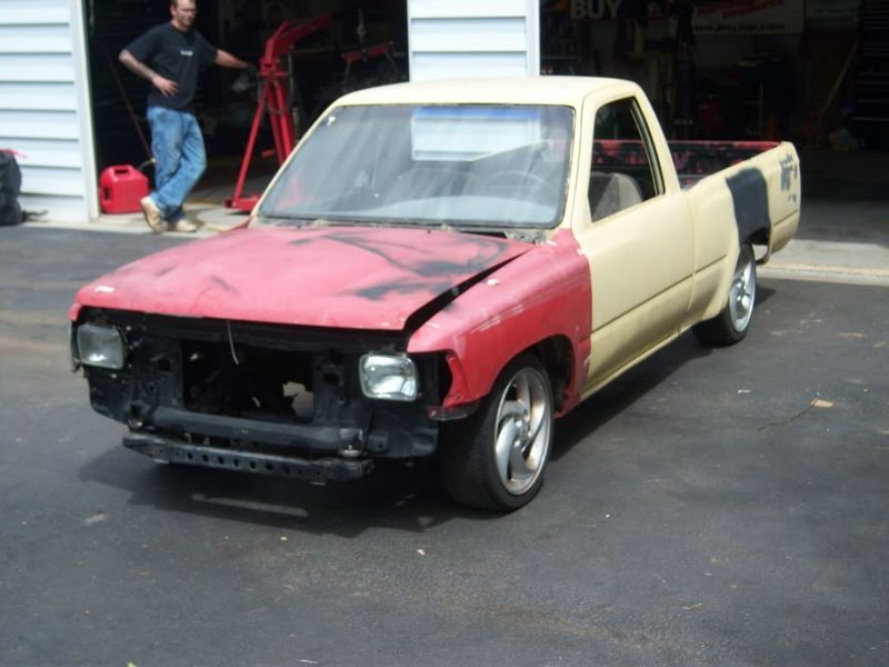

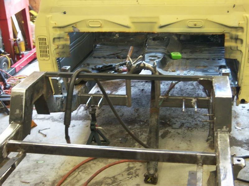

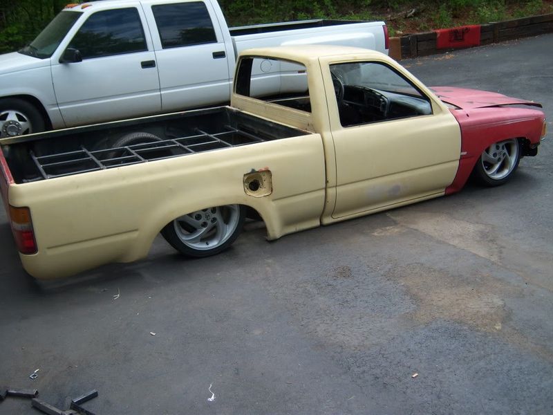

Just a new toyota project me and RABryce have been working on for the last few weeks it will be his new daily when its done anyways let us know what ya think.

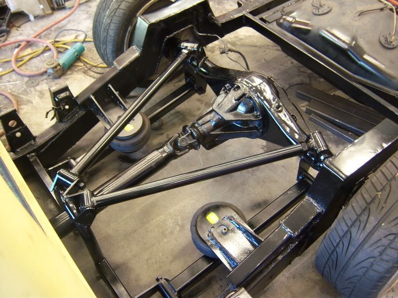

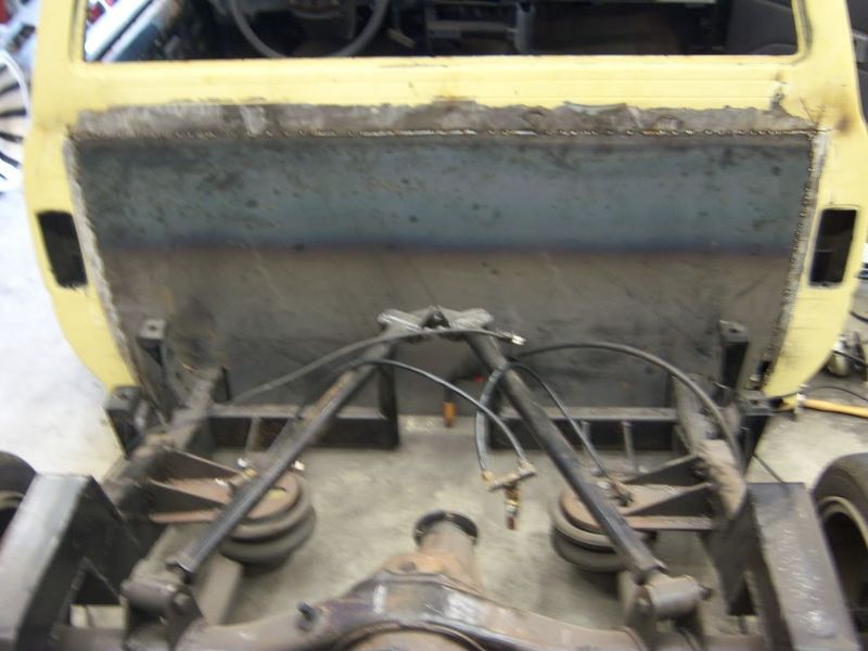

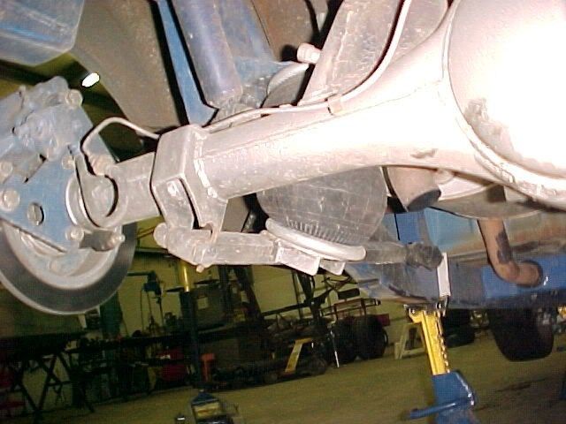

nice looking project.. With all that work why did you offset the bags from the lower link bars? The bags should have been mounted directly on top of the bars otherwise this truck is going to get through bushings. Especially for being a daily driver ..
unhallowed1's avatar
unhallowed1

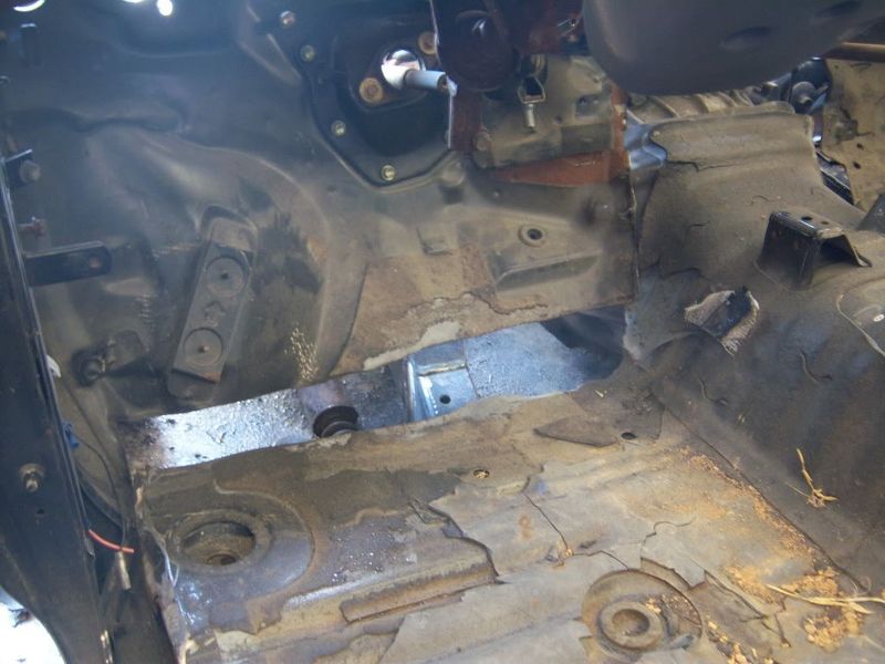

what are ya'll doing with the hole in the back of the cab? blown-thru sub box in the bed?

---------------------------------------------Originally posted by SunsetRangernice looking project.. With all that work why did you offset the bags from the lower link bars?  --------------------------------------------- I was wondering the same thing.......cool daily btw!

looks good Rodney, center those f*ing bags cracker

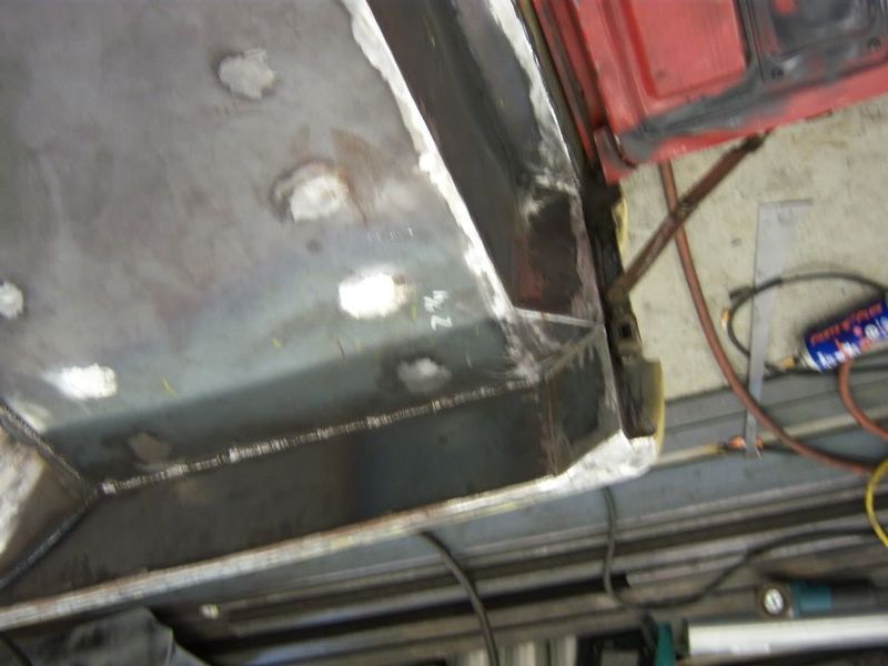

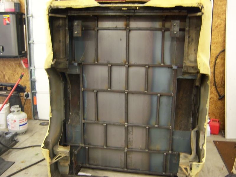

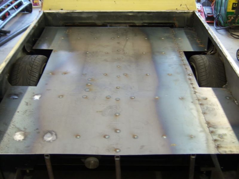

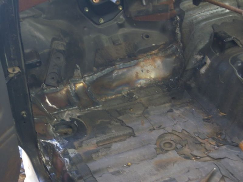

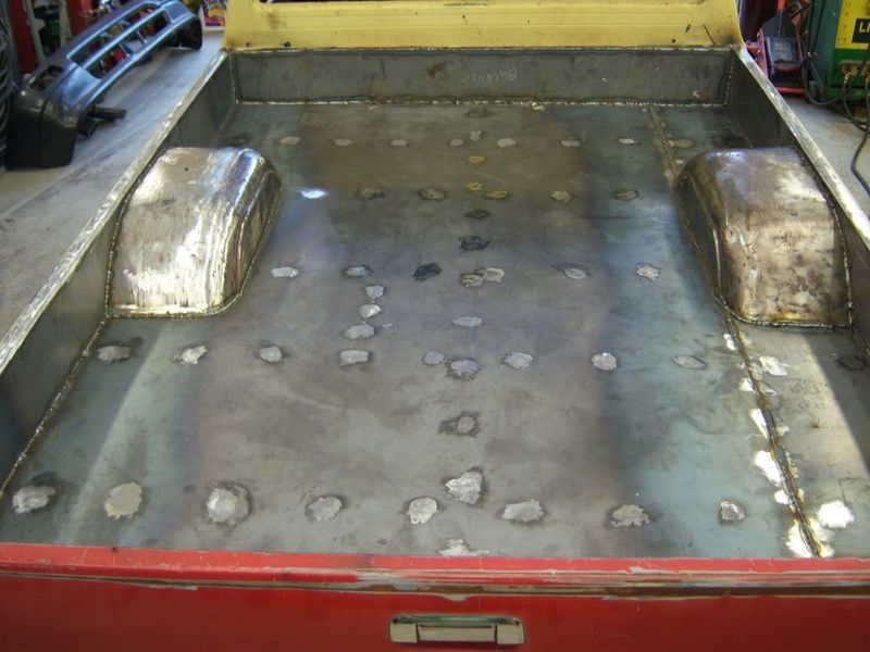

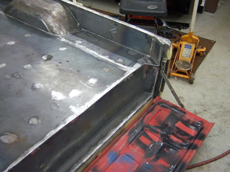

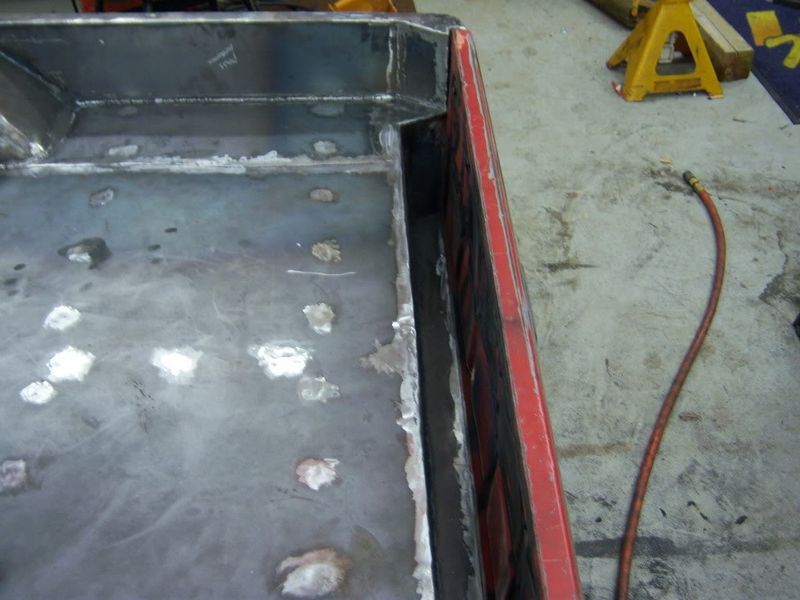

A little sheetmetal work" />" />" />
