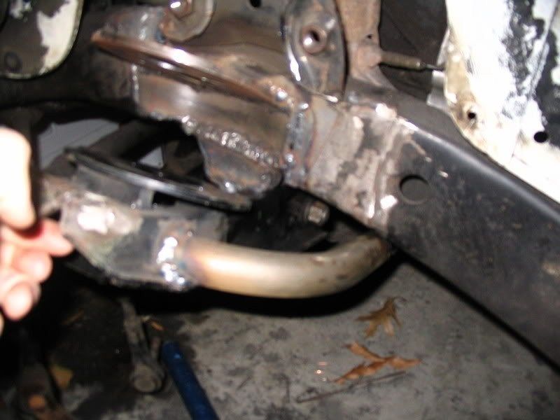

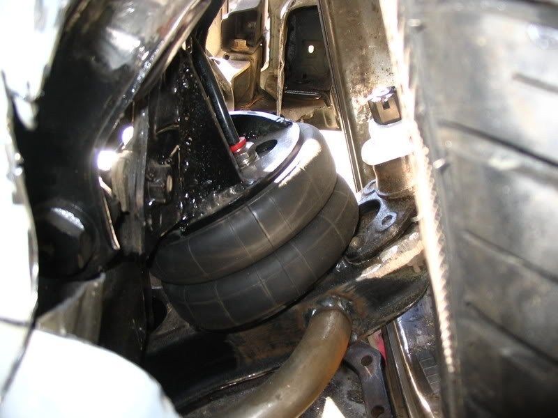

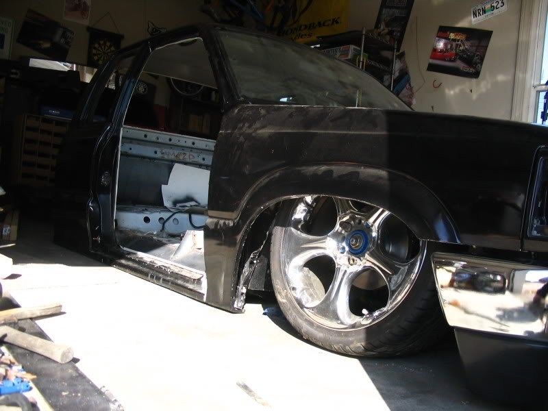

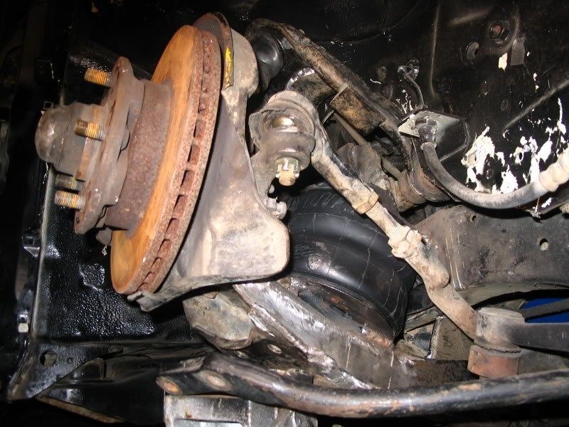

bodied b2600zx (josh)
Ok. . .   yes, lots of questions indeed. . .   Umm. .   I'll try to answer them as best I can so you'll understand. .   First off, they must have really done the bags wrong if you arent even layin out on 17s. .    I have swapped to toyota spindles on my truck and I am about 1/4" from layin out on a 225/35/20 tire. . .   I have notched into the frame on my truck. .   And I am bodydropped 3.25". . .   I reverse pie cut my upper control arms so the ball joints wouldnt bind. .   Most guys pie cut em the regular way to help with camber. .   I cared more about suspension travel. .   So I have reverse pie cut my upper arms. .   and reangled the lower ball joints so they dont ever bind up. . .                      Theres a bunch of pics. . .   A couple show the triangulated arms to get rid of the stabilizer bar. . .   And to make it lay out completely, I am going to Z the front part of the frame up 1". .   That'll get the engine crossmember off the ground and give me a lil more suspension drop so I'm not bottoming out on the bag when i lay out. . .   I hope this helps a lil. . .   Let me know if you have more questions. .   I'll try to help out more if I can. . .   -Josh ☆★J.H. Kustomz★☆

thanks man, i have started notching into the frame using the pics of when you put your build on here. i'll try to get some pics up soon, it looks very much like your set up pictured above, i just need to reangle the ball joints like you have. i need tons of lift to ontuck from a 4inch bd. if you know of anything i can do to get more lift,even like an inch please tell me,  your pics really help man i appericate it.
