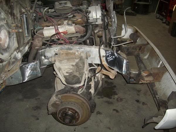

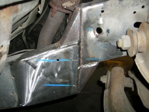

a "Z" is done to raise the engine crossmember,that way you will lay true and flat frame   courtesy of Keef's Rod&Customs

---------------------------------------------Originally posted by SoloSpecialtiesa "Z" is done to raise the engine crossmember,that way you will lay true and flat frame courtesy of Keef's Rod&Customs ---------------------------------------------nice so should i use the original control arms or get new ones?
