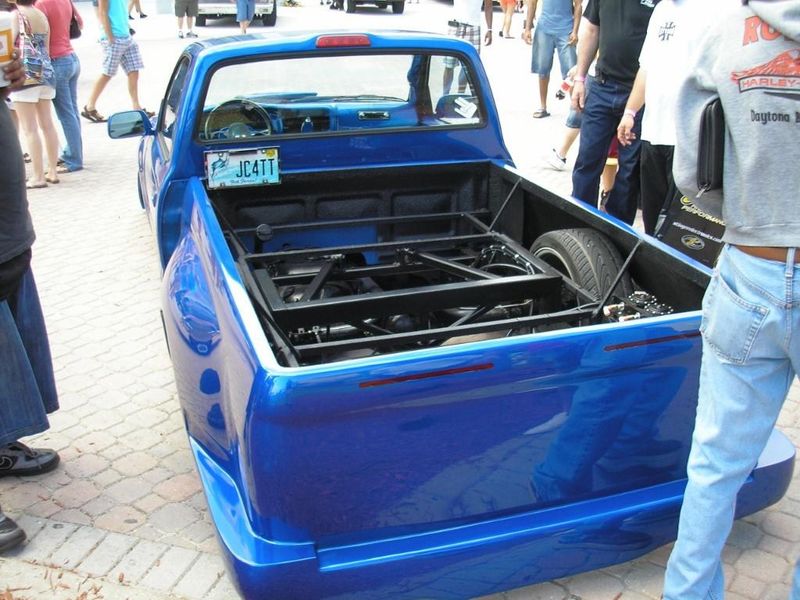

---------------------------------------------Originally posted by draggin95nisshow do u hide led tails in the paint.....---------------------------------------------are you talking about not being able to see the LEDs until you hit the brakes? Totally Polished did that with their Xcursion.<img src=http://www.totallypolished.com/X/tailightoff.jpg img><img src=http://www.totallypolished.com/X/tailighton.jpg img>
ElCadillacKid's avatar
ElCadillacKid
are you talking about not seeing the LEDs until you hit the brake? Totally Polished did that with the Xcursion.
