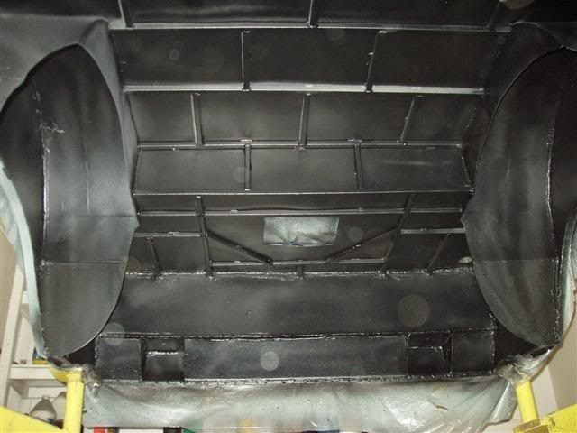

I made a filler piece come up from the lip of the 1/4 panel to the top of the tub. So the tubs are attached to that, not the actual 1/4s.

Yea I had thought about that but, I rolled the fender lips because I slit one of my tires moving it around a while back. I could probably still go off the rolled part however it would have been buch easier dealing with the compound curve the way you did it. Thanks for the pics Joel.

mine are done the same way as joel's. just not as pretty cause they were getting rockerguarded anyway.

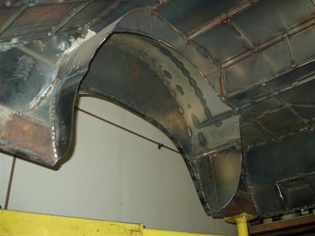

Edited: 5/16/2009 2:04:09 AM by k24 rd6
On mine, it was done like above, except my lip was cut off and welded, and there is an inch or so of the factory wheel well to weld to. Sheet metal was welded between the leftover inch and the tub then seam sealed. You can sort of see it in the pic, you are looking upward and the top of the pic is the outside of the quarter
