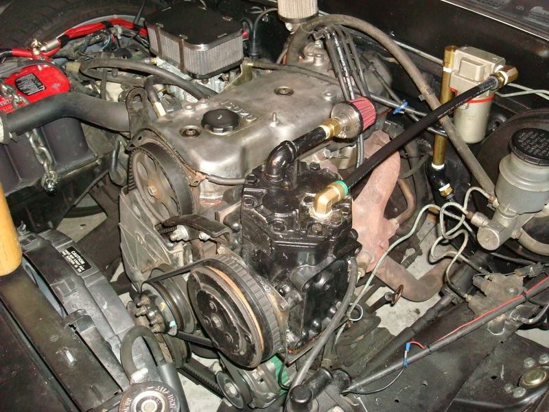

bjscustombillet
Here is a pic of mine from when i was doing my engine mock up. Keep in mind that I also changed the alternator and the Ac compressor.  http://www.streetsource.com/issues2/viewPhoto.aspx?Type=Magazine+Show+Coverage&Photo=/uploads/Ownerprofiles/bjscustombillet/412009111942AM50091.jpg&Thumbnail=%2fuploads%2fOwnerprofiles%2fbjscustombillet%2f412009111942AM50091_tn.jpg
