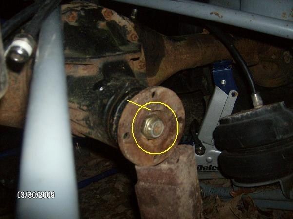

so i can probley fig. out what to do but im sure that some one out there has done it and has an easy way to do it.how do i mark up the rear end on the youta for the nissan drive shaft. N E help on this would be good.

from what ive seen they fit just have to drill the holes out a little more and bolt it on

the 4 holes or the big hole in the middle that kind butts them together?

the four holes on the drive line  what year toy you have  i know 1990 fits on just inlarge your nissan driveline to line the holes up   hope this helps

its a 90 modle yota rear end,ya there is a hole in the cinter of. like you have the 4 bolt holes and in the middle ther is one on the drive shaft its like 1"1/2.with a rased lip.and on the rear end ther is the 4 bolt holes and 1" hole with a big nut in it, i gusse this is to hold the flag to the rear end.ill try to post a pic.
