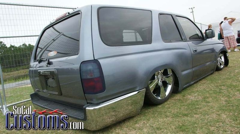

my 2runner has an underslung frame as well as my v8 taco roadster and my buddies t-top taco the biggest challenge is getting the shocks mounted and rear brake lines ran i get 10" of lift w/ 20's i have 2" bumpstops on it so with those i only get around 8"  but i didnt build my truck to be low to ride high i prefer the street sweeper method
