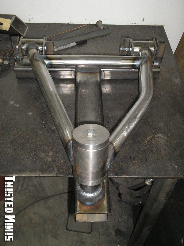

can ever one post pics of jigs they use to build lower control arms

If the fixture is for a one time use project, I rarely build one. I will use the truck and the spindle to hold eveything in place. If the fixture is going to be used more than once then there is a bit more time involved building it. Mine usually end up looking like something a packrat would make, using pieces and parts from this and that. I'll try to dig up a good pic of one.

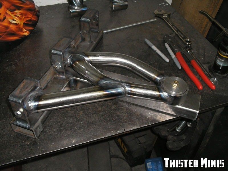

Here is one of mine from another thread.

Mine usually look something like Max describes, lol. I believe I actually wrote "This is a jig, do not throw out" on the last one I made due to its uncanny resembelance to a chunk of scrap iron.  Good job on yours Seth, looks almost as good as the arm in it.

seth's jigs are masterpeices
