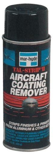

Aircraft stripper...
tattoominitrucker
if you use that aircraft stipper watch u dont get it on the paint (duh) or on yourself too long it will burn some say it will eat your skin ........but good call marcos

you can try everything listed but it wont work with little effort. you will go through 20 gallons of laquer thinner and still wont have most of it off. air craft stripper doesnt work. wd 40 works cuz it breaks down the oils but youll need a bunch of it. the stuff on the frame is a tar and kasmolene mix. the best and only thing that i use and you can strip an entire frame in an hour or two is a stream pressure washer. then coat it with a light coating of wd40 till your ready to work on it. if your going to paint or powdercoat it dont coat it
