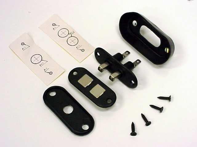

I have a 2003 ford f-150. I need help with wiring up my rear doors i cant find anything to run wires threw that will not bind up while closing the doors. does anybody know what i can use ? or how they have ran wire before. or pictures may help me

Are these something that may help you out? http://www.illusivefabrications.com/html/modules.php?name=catalog&file=index&cPath=58_61

you can also look into the contacts that are on van sliding doors... however if you need power when the door is open then these will not work,

I don't have suicide doors,but I did use braided looms @ my doors. Drivers side has 10 wires going thorough it & that's a tight fit. They work great. The pad/pin type are available with as many as 12 contacts I believe.

when i did the doors on my toyota i used dakota digital's wireless door jam connectors.. they work great and look even cleaner!
