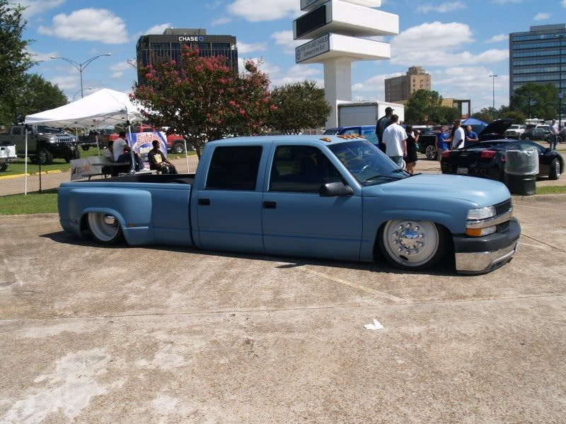

IVE SEEN IT DONE ! DONT KNOW HOW , BUT THERES A BABY BLUE PRIMERED DUALLY RUNNING AROUND WITH WHITE STEELIES 22'S ON IT

HERE I FOUND A PIC FROM LAKEFRONT

Yup those are stretched.  The tire doesnt sit on the bead of the wheel.  the steel belts that go around the bead of the tire can break and you tire will pop off the rim like a bomb.  The ones that have milled aluminum wheels run them on all six.  no steel inners
