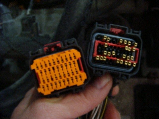

Anybody have a clue where i can find a wiring harness for my 04 quad cab with the 5.7. I'm missing the insert on one of the plugs that plugs into the ECM. None of the junkyards have any around San Antonio and the dealers want over $1300.

Do you have a picture of what you are looking for? I would keep trying the junk yards, you shouldn't have to settle for buying the whole harness if you need just one clip.   I found this one on ebay but it's for a 2005 with a 4.7 so I'm not sure if it would work?   dodge ram harness   Hope that helps?

Gonna go take a pic now. That's about all im finding around here. (4.7)

of course the part i need is the insert on the right

found a donor but need to know if the wires can be spliced. anyone?

Which color was the plastic on the other plug that is missing? I have a fist full here at work.  I may be able to help ya. I heard it was either black green or something else.... If it was black, we are using all of them. If its yellow/orange or green i have a bunch of them

i never saw it. it was missing when i got it back. the one on the donor is black

yeah the dealer told me the black one is the only one they dont have. do you know if i can splice a new one in or should i try to replace the whole harness?

YES you can splice in just make sur you do one wire at a time and solder the wires and use water proof shrink wape.  go to the dealer and tell them you want part number 1-cbrah070 that is what dodge sayes use. if you need anything else let me know i work for dodge dealer...
