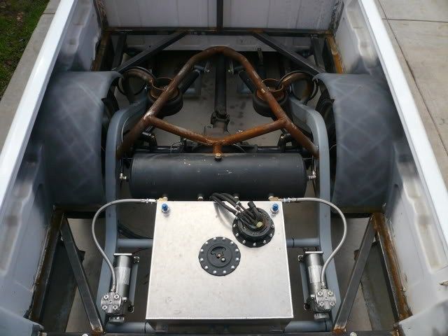

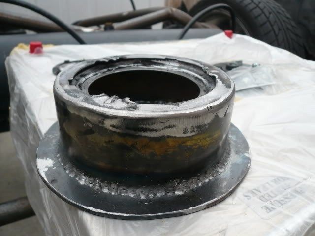

Every one i know with a cell has a jegs tank, I have one too. You can make an adapter for the stock seding unit/pump and it will work and read just like factory. Sorry, these are the best pics i have at the time. This is for my S10, but it can be done the same way for any other truck
