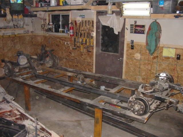

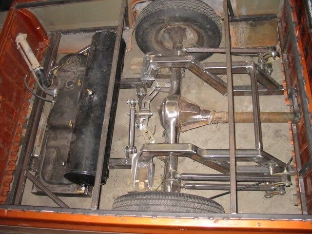

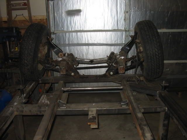

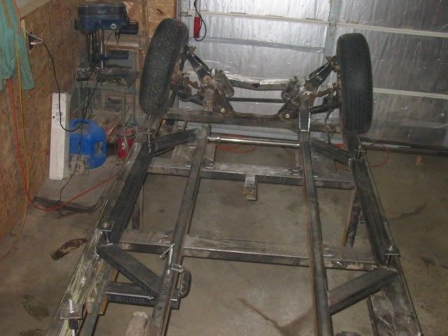

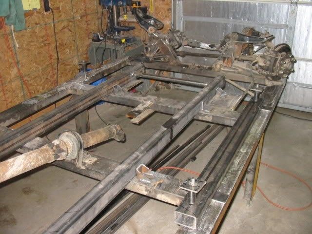

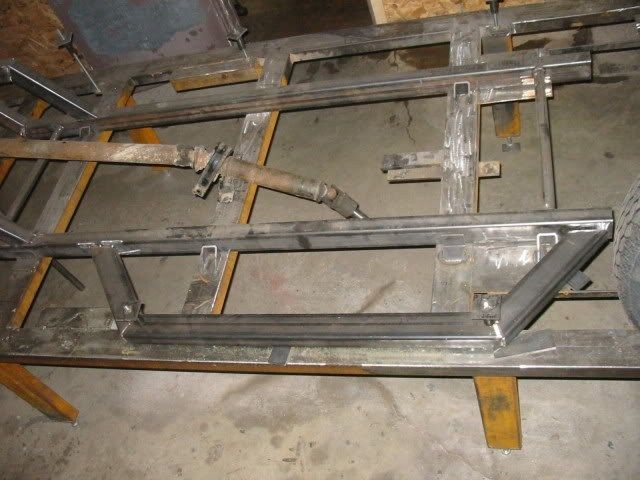

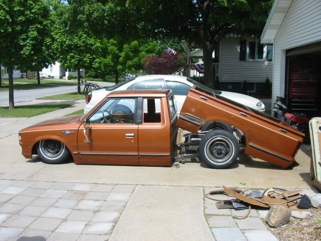

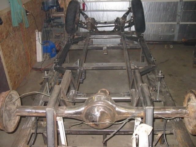

Started the teardown for my 83 720, bed is off and interior mostly gutted. The plan is a SFBD 2.5 inches and either roll or cut off the pinch. Parrallel 4 link, bag on bars with watts,manual air manegement, tilt bed with topper, targa top, 16 inch billets and sheetmetal interior. the frame table waiting

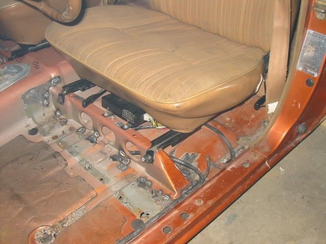

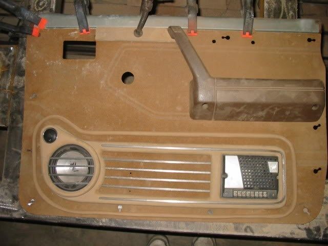

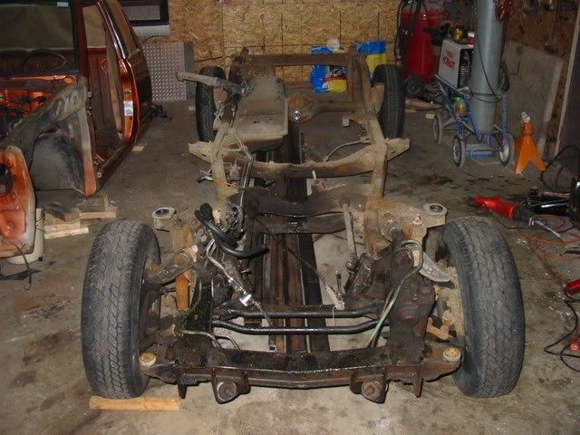

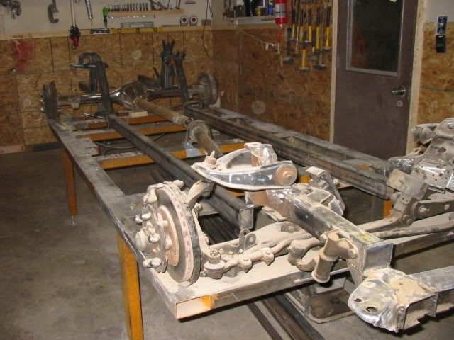

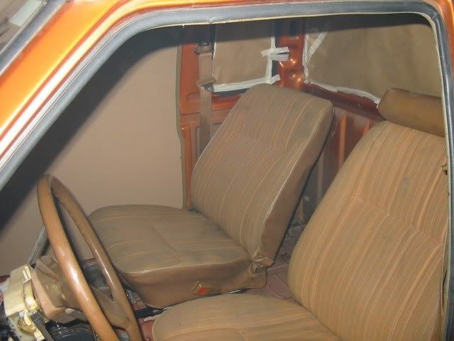

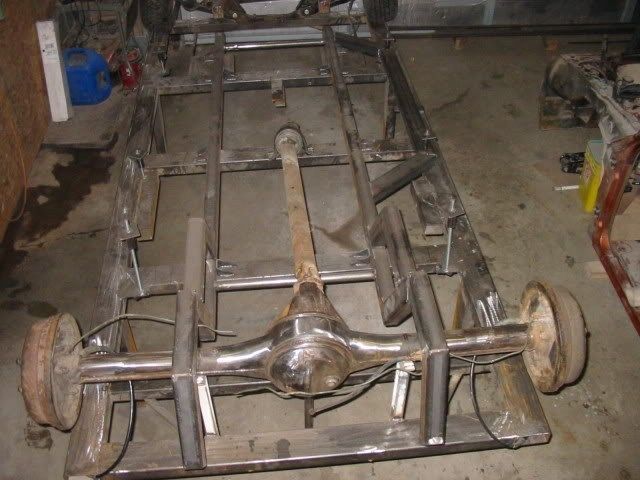

frame is on the table and about to be cut up, should be working on this very soon. I will also be working on sheetmetal dash console and doors as well.  Seats are moved back 3 inches already.   tried to post pics but it didn't work this time... will try to fix that.

seats back 3 inches

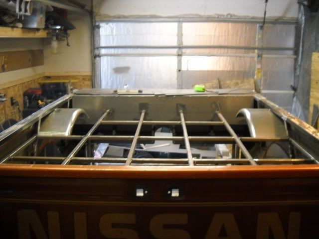

I never realized 720's have cleats on the bed sides. That's different!   Good luck with the build Jayme, gonna be one helluva truck
