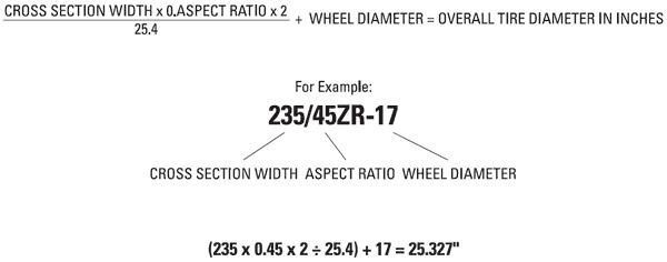

whats is the overall diameter difference between 245/35/20 and 225/30/20?
N
neurotic
LaynRockers's avatar
LaynRockers
http://www.miata.net/garage/tirecalc.html   That thing is killer and you can put both in and it will give you all the info you want to know about them   John
