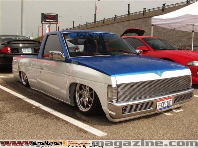

<P> <P> my buddy has em on his nissan. they only used the top half of the 4x4 front fender (from the body line up) still looks kick ass! here is a pic of the truck > (pic below...)
BIGbrew
ah, there we go! google is your friend. lol
