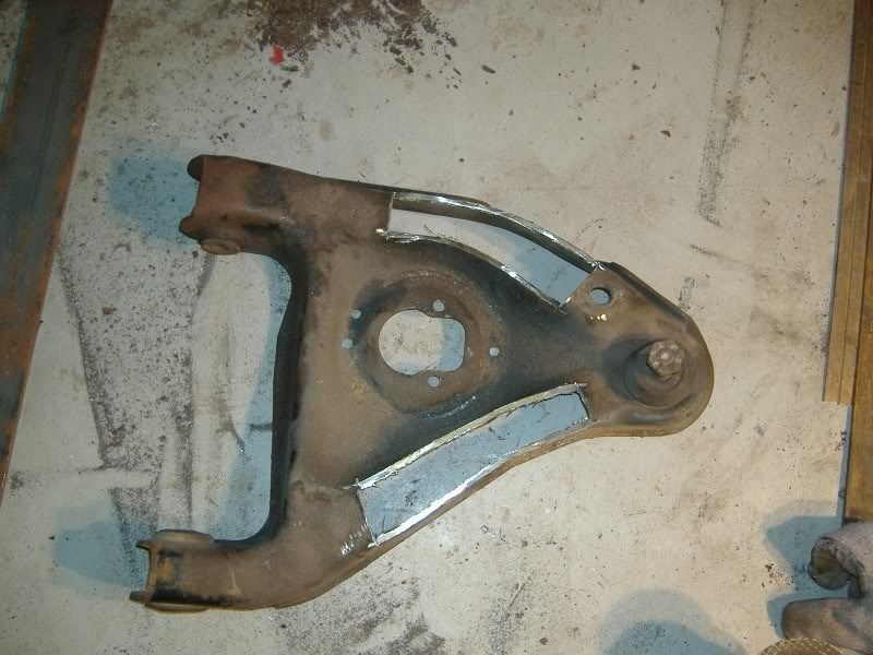

BJ_waylayed's avatar
BJ_waylayed
Dehumped S10 A-Arms

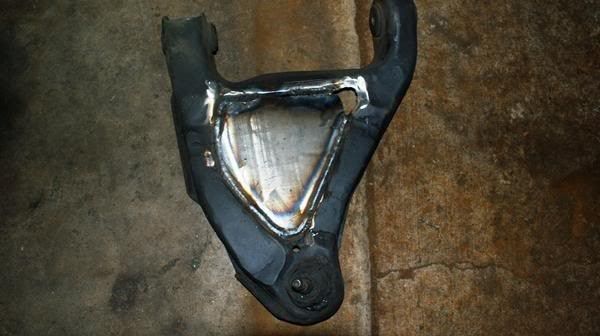

86mazda
dehumped and plated
s10
