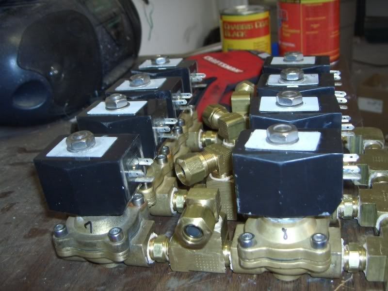

standardbyker88's avatar
standardbyker88
thats a clean ass valve setup. i like that. and yeah, 2 links are generally solid, not pivot, mounted at the axle...so it can really move side to side. not much air transfer. and leaving the front sway bar its not that bad with a good shock. my buddys 01 chevy was setup like that. he redid it without a sway bar when he bodied it. he needs to put more valves now for the front. rear is a 2link, so it doesnt make much difference.
