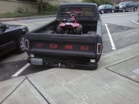

I've done a 64 that was solid front axle. I had sid from droppedaxels.com drop the front axle 4" & install new kingpin bushings then dearched 3" out of the leafs. left 2.5" between axle and frame. The rear I notched and flipped the axle for 9" Im trying to find the pictures now.

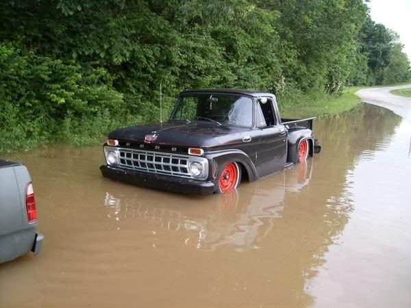

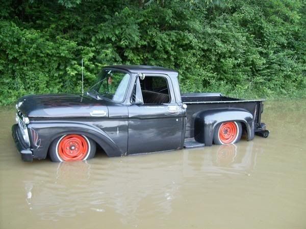

This is my buddies 63 with a still rocking the solid I beam front on bags.
