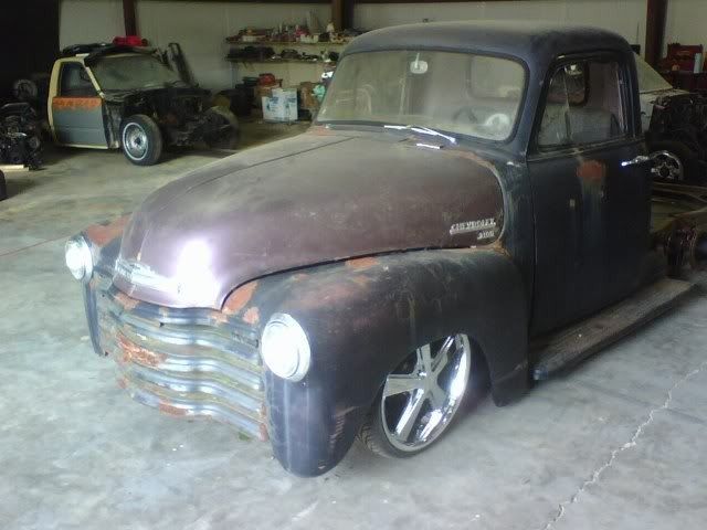

well jus figured id show what ive been messing around with lately. nothin fancy but i always liked em. its a 55 chevy first series. basically a leftover 54. still got the id plate to prove it. was built in good ole atlanta. will be put together to make a fun show trip cruiser. ugly but funtional and drive everywhere.
what it looked like when i drug it home

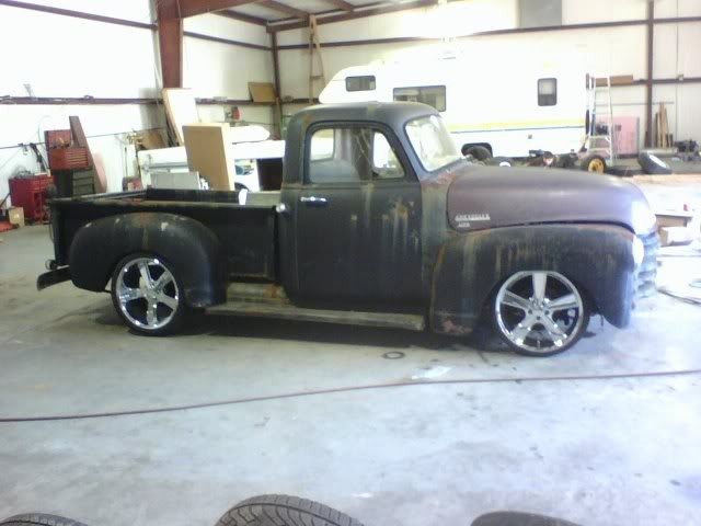

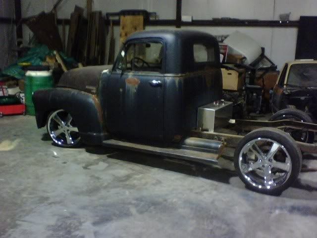

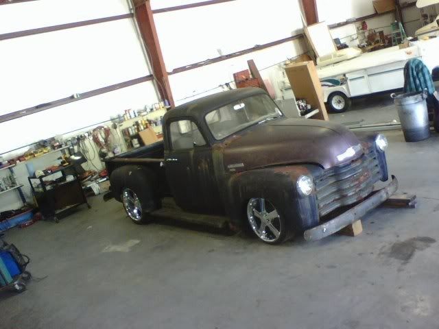

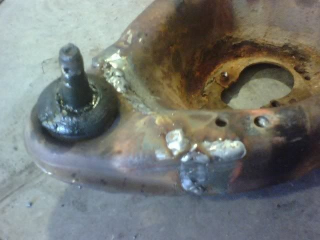

but the ford 9" now sports sum nifty rear disc brakesthe front noe has s-10 drop spindles and brembo cross drilled and slotted rotors and all new everthing. also shortened the lower arms an inchas it sets now. 3" blocks in rear with the axle flipped. 2 inch spindles in front and cut coils for 1 1/2 drop also. my pup also gave up its wheels for now. 20x8.5 and 20x10 kmc novas.trying to get it all mocked up.as it sets now. rci fuel cell is not mounted btw. has 4 wheels power disk brakes. stole a booster and master off of a c-10 and mounted it on the firewall. willwood risidual valves and proportioning valve. lokar nostalgia shifter on the turbo 350 tranny. serpintine belt setup. buncho misc stuff.
