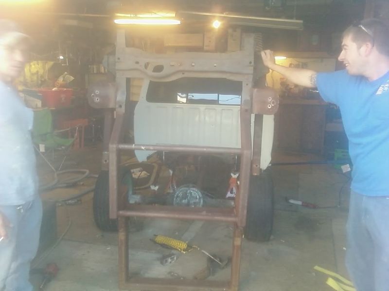

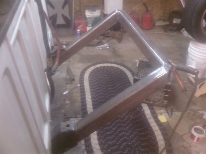

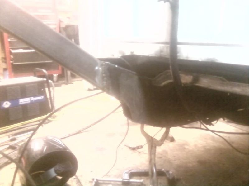

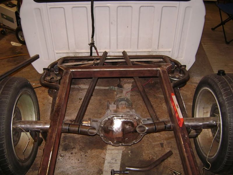

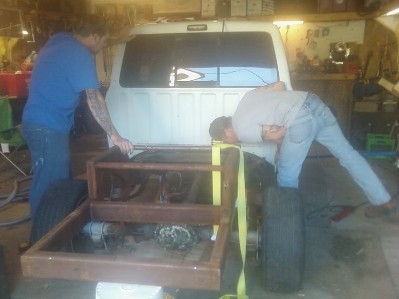

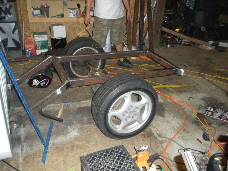

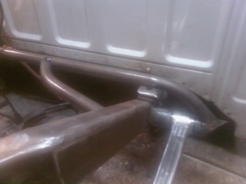

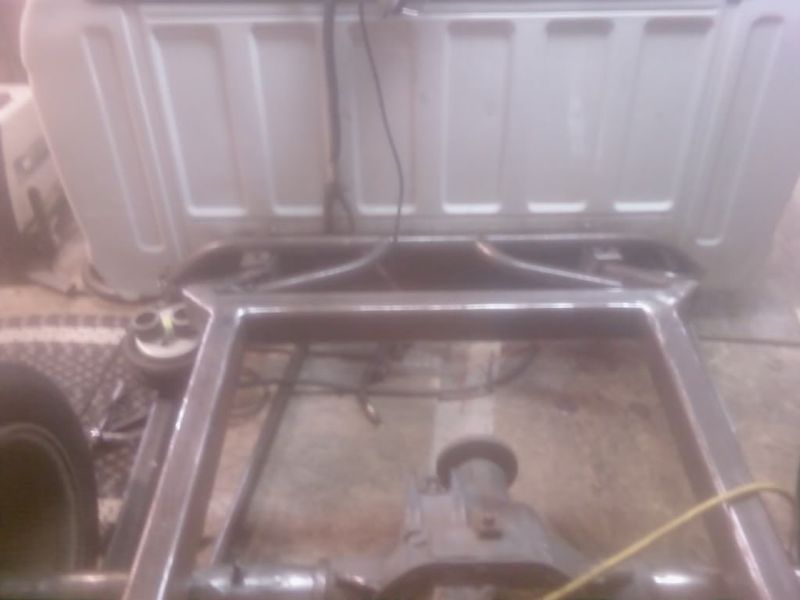

When I bought it first order of business cut it upshady fn work bag mounts bent no bracing thats why i cut itbegining the back halfmoving alongboxed in and braced upthe frame complete minus some gusseting
my lowers link mounts and crossmemberbag mount

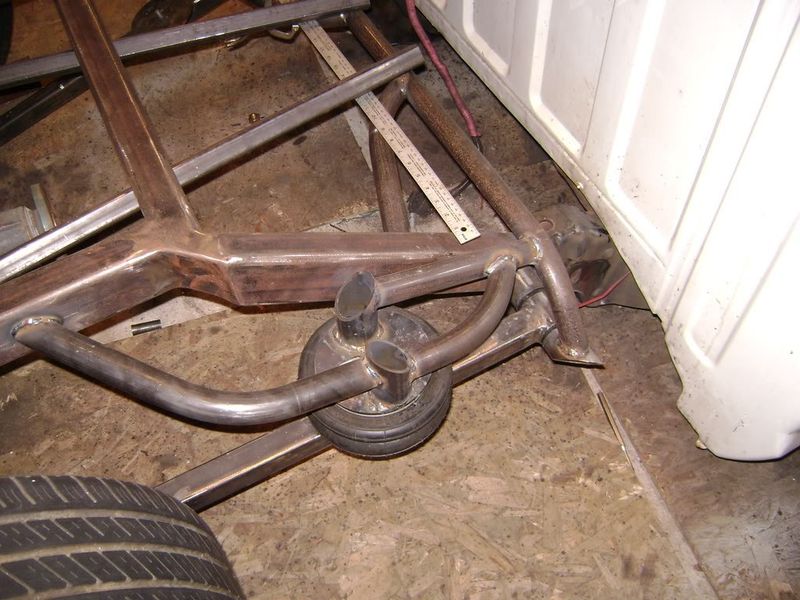

here are my upper bars they will stop at the ruler and they're will also be a tube connecting the inner upper axle mounts together then to the rearend the outer is connected with some 1 3\8 .250 tubing, I just bought a JD2 bender and this is my first back half and attempt and using tubing bender and notcher let me know what you all think..

there you go man, fixed it for ya...
And i think it looks good man, im building my 92 ranger right now, got anymore pics of your front setup or anything? where you from?

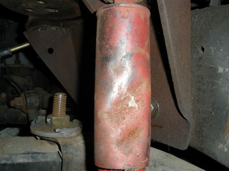

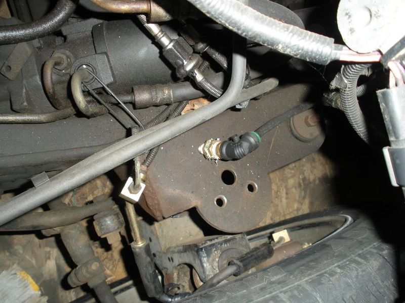

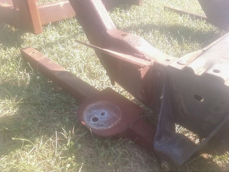

Aint started on the front yet the people who bagged it before did a terrible job some hacked up front bag mounts the whole bag and lower mount was rubbin on the frame im gonna do two tubular mounts too the frame with two pieces of tubing at angles mounted too a circle plate like the ones i used on the upper bag mounts in the back. For the lower mounts im gonna use the ones from suicide doors they give you the right angle for the bags then all i have too do is to lay it out and match ther upper mounts with the angle of the lower mounts. My buddy already ordered the ranger kit from suicide doors and the radius arm crossmember I just took those and measured of them and made my own. I kinda wished i had gonna ahead and built a full chassis and stockfloored it. But maybe next year. Thanx for posting them pics I messed with that forever. By The way Im from Lexington Ky names Cliff
the lower mount was attached to that bolt that holds the beam in theres the old upper front mountsanother picture of the old uppers
to make the pics work post the link to the picture inbetween this code ^img src=PASTELINKHERE.JPG> Just replace the ^ with Your not too far away from me,And if you wanna see pics of my truck check out on here:My Buildup

Looks like you are doing a good job of making it into a safe and reliable cruiser. That was some nasty ass shit you cut off of there, thats for sure! Quick question, would you do it all over again or would you start with a stocker instead the next time?
slammedstroller
I like it! good work
granth
does having your link mounts that far behind center on your axle have any negetive results?
