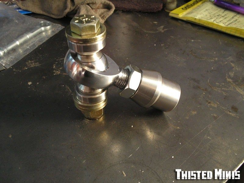

Anyways, if you use cheap rod ends they will wear out fast. But if you use a nice rod end it will outlast a poly bushing. I use chromoly FK rod ends by QA1.
By the time you have the rod end, jam nut, tube adapter, and high misalignment spacers, you're looking at around $40-60 each depending on the size you get. 5/8" would be large enough for one end of a 4-link. I use a 3/4" or 7/8" rod end on the single end of a 3-link.
