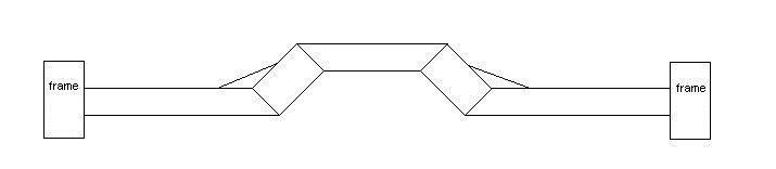

yea ive heard of people doin that, but i just dont feel safe even though everyone says theyve never had problems. If the crossmember isnt right against the bed floor, im going to build a notch for it. Does this look ok? I wasnt sure if i need to gusset it, i cant put gussets on the bottom because i need as much open space as possible.

that will work just fine.
