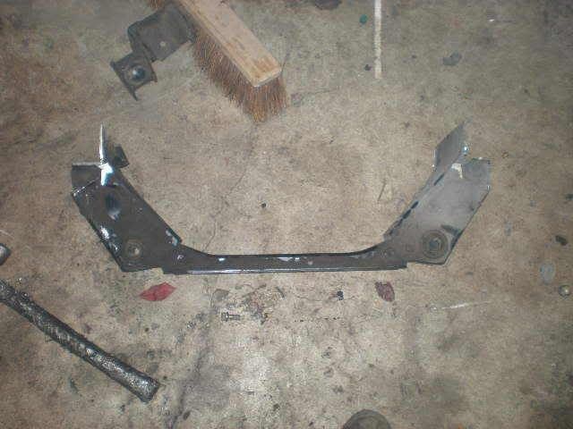

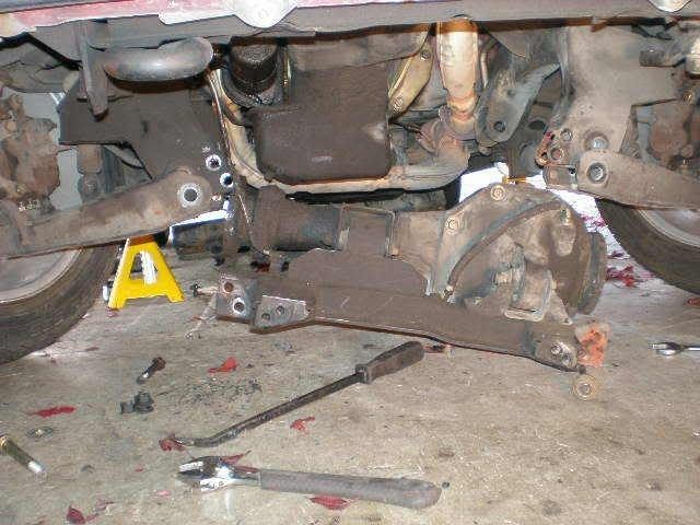

made some progress today got all the 4x4 ripped out. i ended up using a 2wd hardbody lower suspension crossmember, just for ease and quickness of installation. I'm going to triangulate the LCA. need to get a 2wd pan the 4x4 pan hangs down below the 2wd crossmember like 2 inches.oh also found a brake upgrade for the 2wd guys 4x4 calipers are two piston and bolt right on the 2wd spindles just trim the backing plate a little.

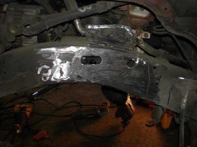

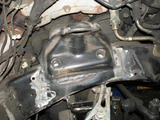

got some more work done today and picked up a 2wd pan to swap on. and ordered my front bag brackets. all that's left is triangulate and bag and gusset the crossmember.

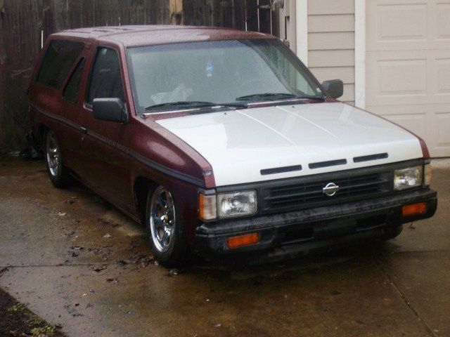

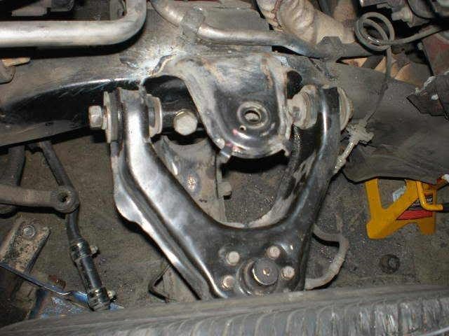

top shot of the suspension all in
had to toss in some shocks so the dam thing would roll....

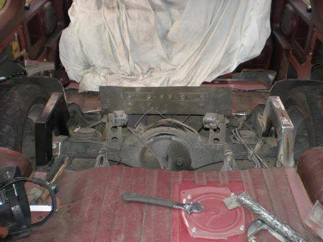

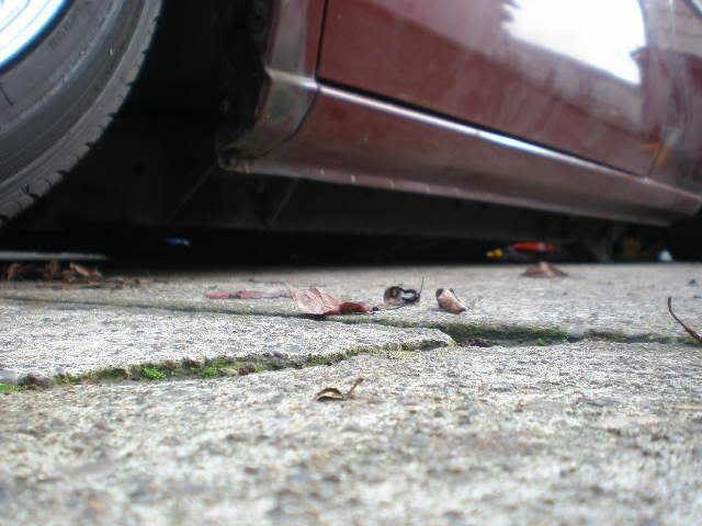

got more done

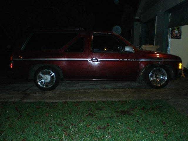

Update on this truck I own it now.I have big plans for her including all chrome HB front end and new hood minus vents. Finish bagging her and 20"s and maybe a BD

are u using flux wire?

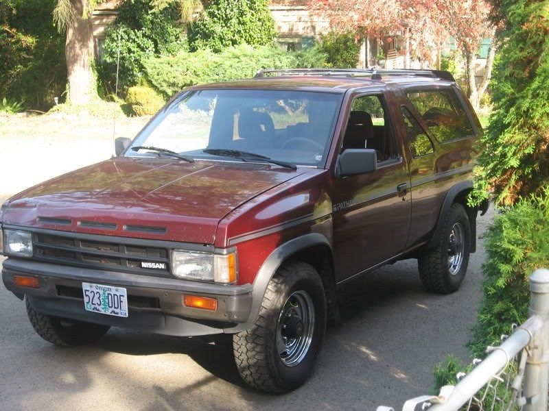

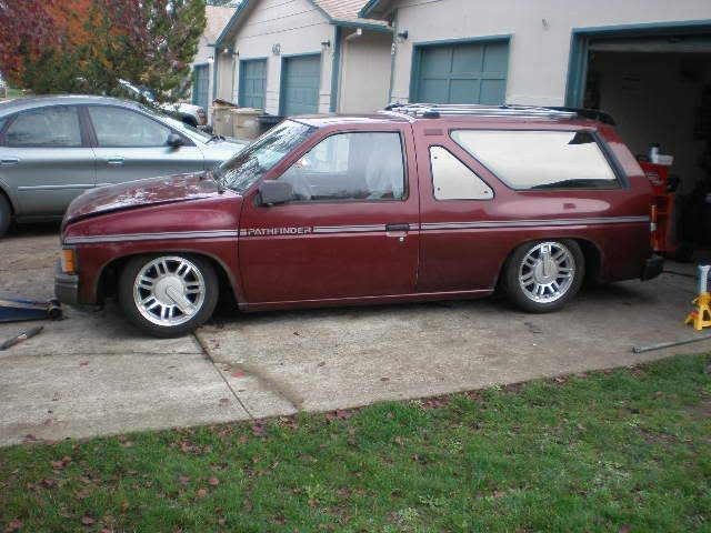

oh man that last pic is so f'n old school, the drop and pathfinder wheels on the 1st gen pathfinder .......... WOW
