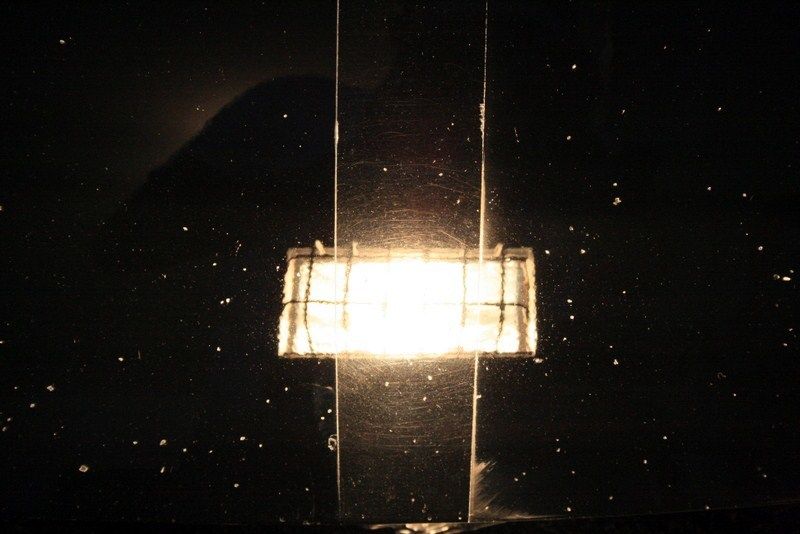

BEFORE:

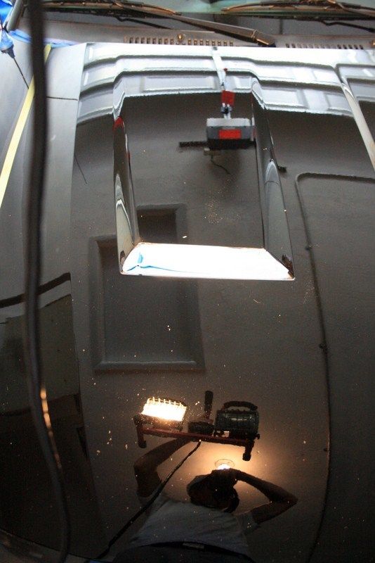

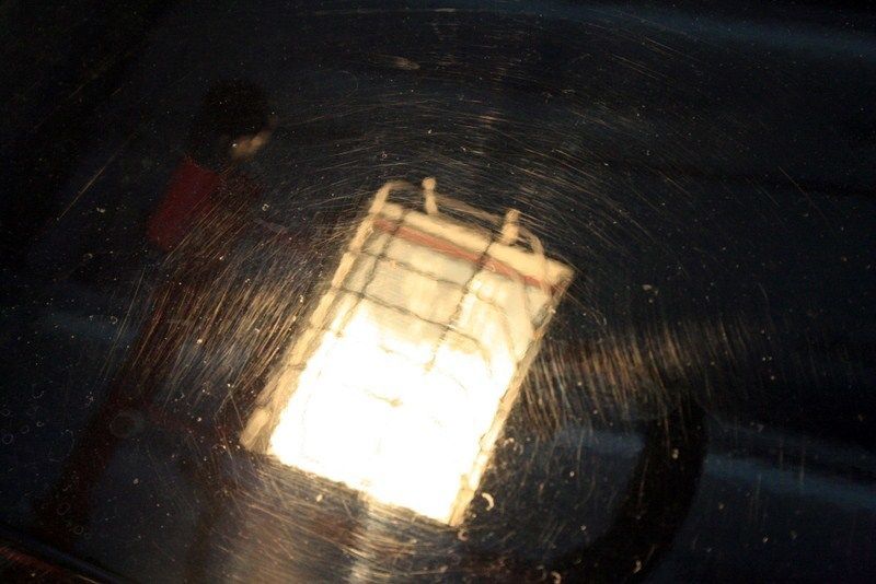

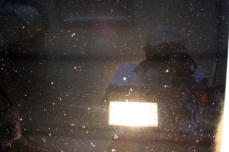

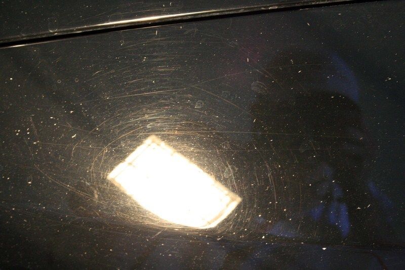

The hood was horrendous looking with deep swirling and holograms galore! the entire hood was like this...
TT
the twanksta

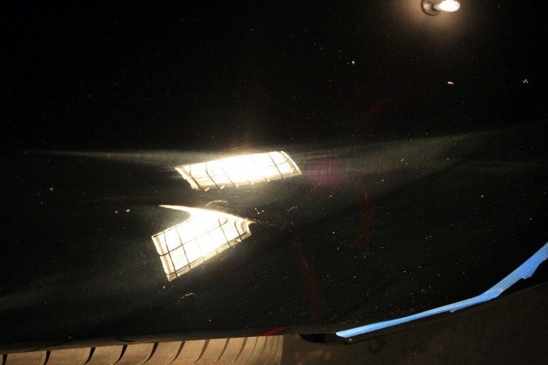

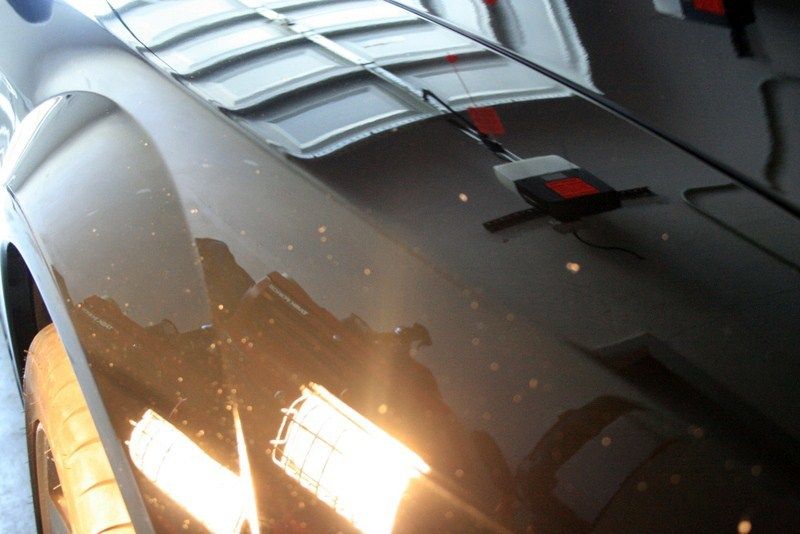

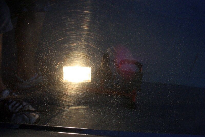

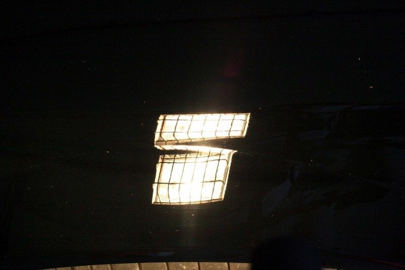

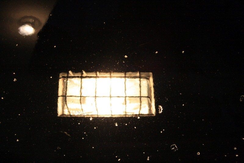

Now in the halogens.. :ignore:
Hood..
Front Fender..
Front Fender..
Door..
Rear Fender..

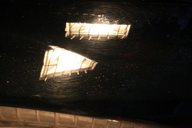

50/50 with SIP/PFW..not quite enough but almost.
This side with M105/Burgandy Wool. It left its own marring but it removed all defects very weel and in VERY LITTLE time. Was almost effortless!
This side with SIP/PFW. I got a pretty good finish with this combo, however there were still traces of defects throughout the panel and took considerably more time to remove less defects. So I chose to do the car with M105.
SIP LEFT/BEFORE/M105 RIGHT
I did a small section over my M105 panel with 106FF/LC FLAT WHITE and found no holograms just as TSC17 said! Saved me ALOT of time!

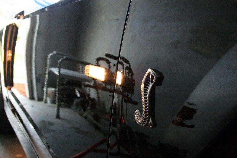

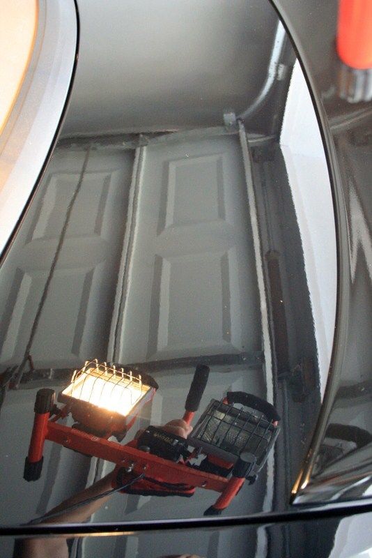

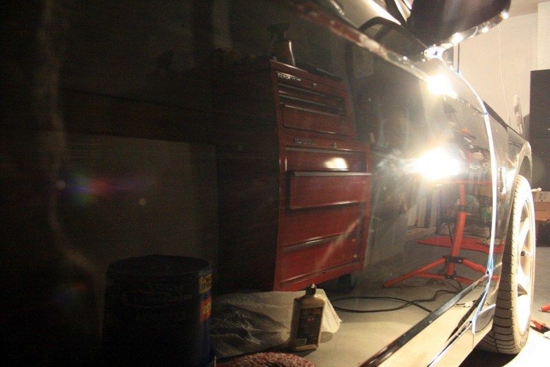

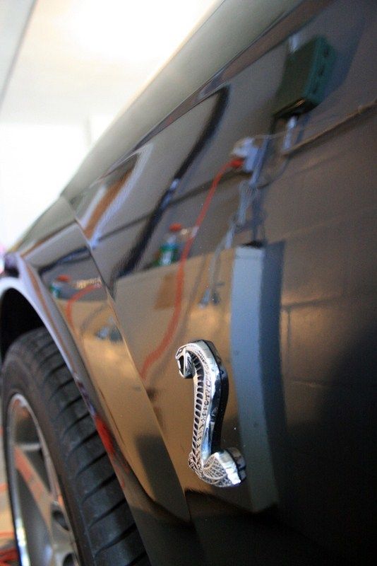

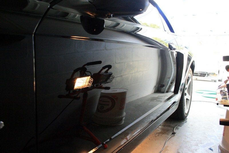

Driver/Passenger door after M105/Wool x2

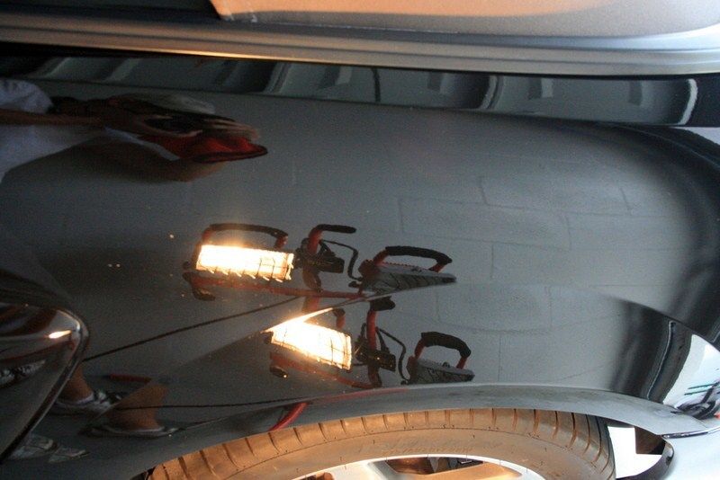

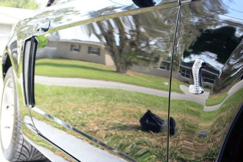

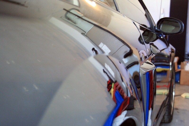

Fender Before:

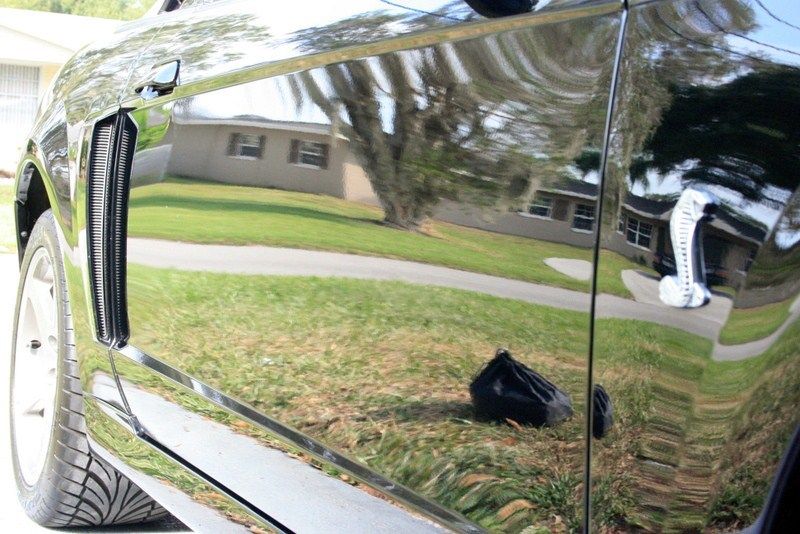

Fender After M105/Wool x2

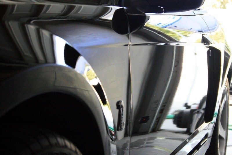

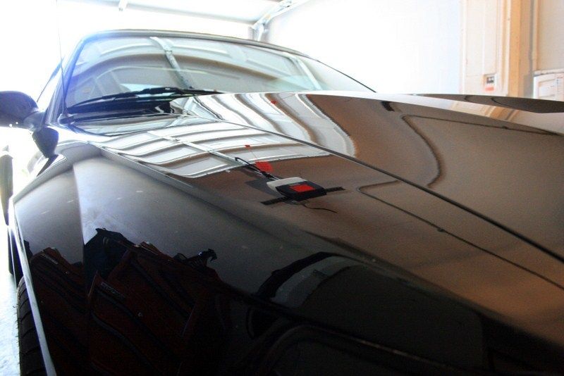

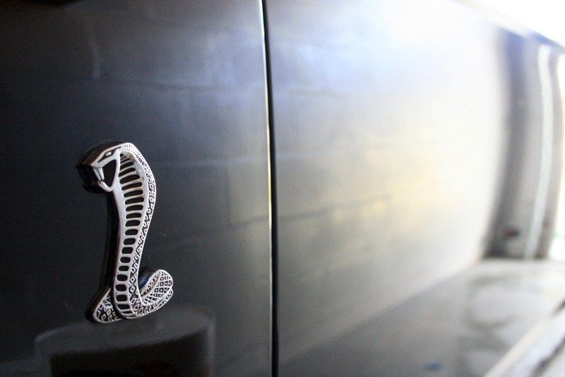

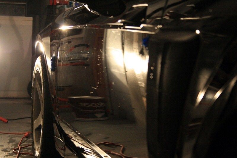

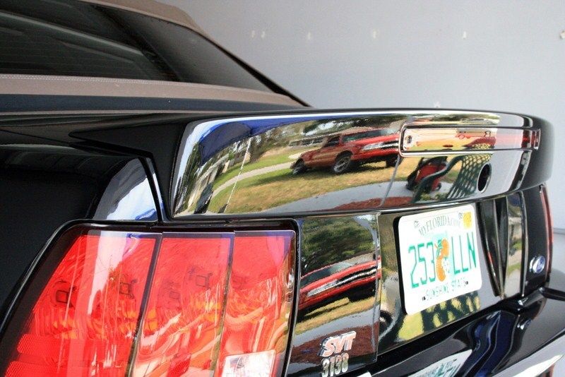

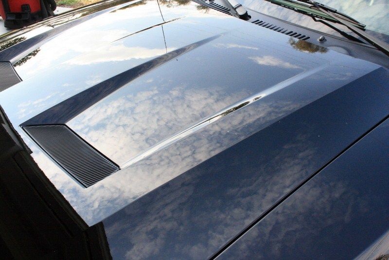

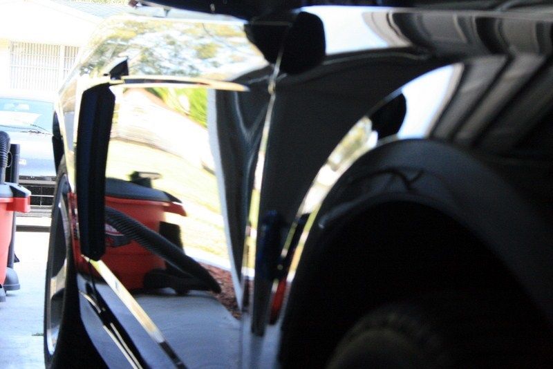

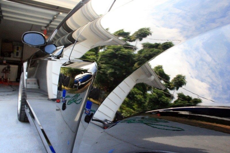

After M105 x2/106FF..
One of my favorite pictures I took..
post photo post photo post photo post photo post photo post photo post photo post photo post photo post photo post photo post photo post photo post photo post photo post photo post photo

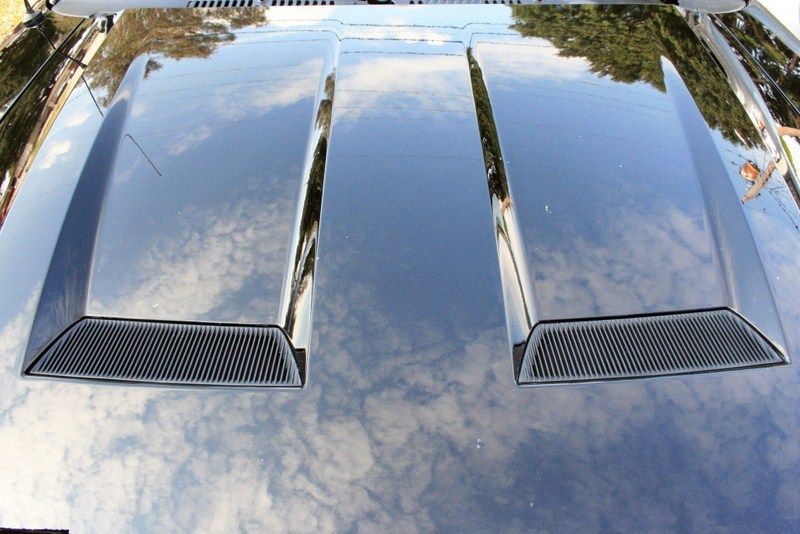

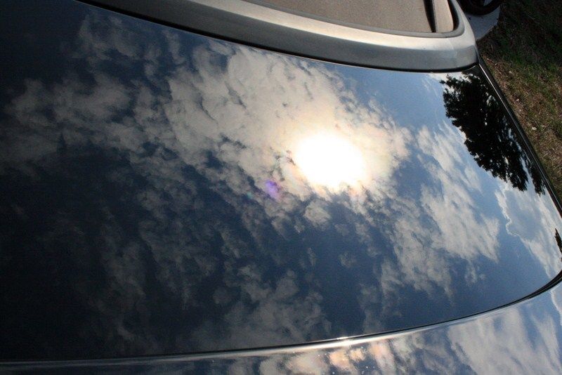

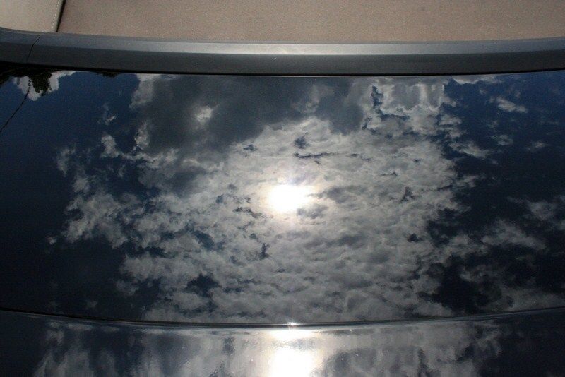

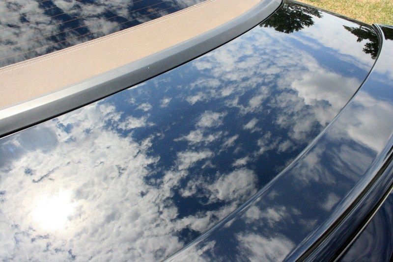

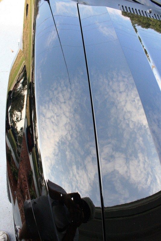

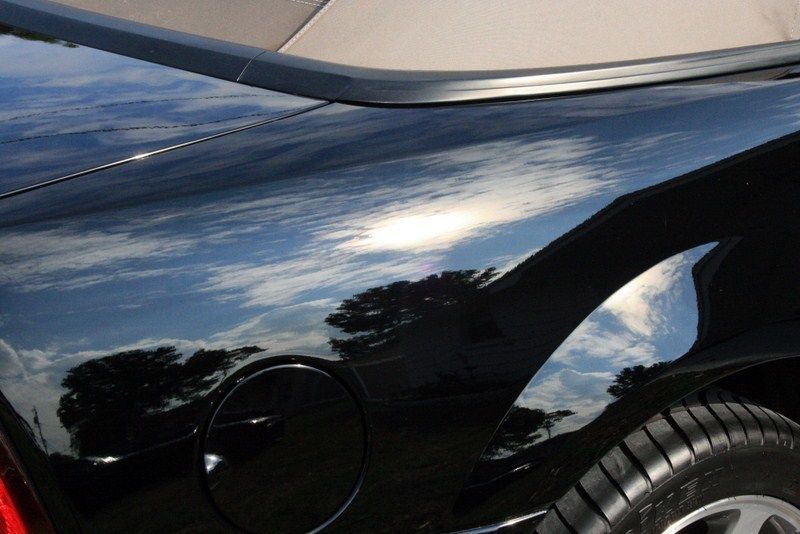

SUN SHOTS!! Kinda..there was a little overcast.
