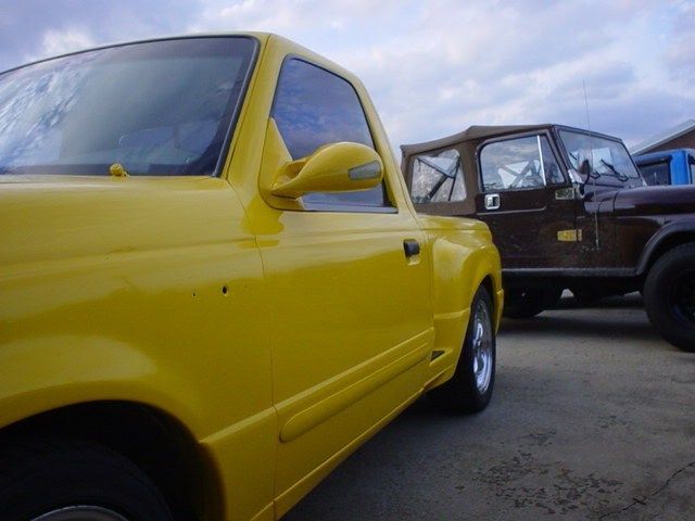

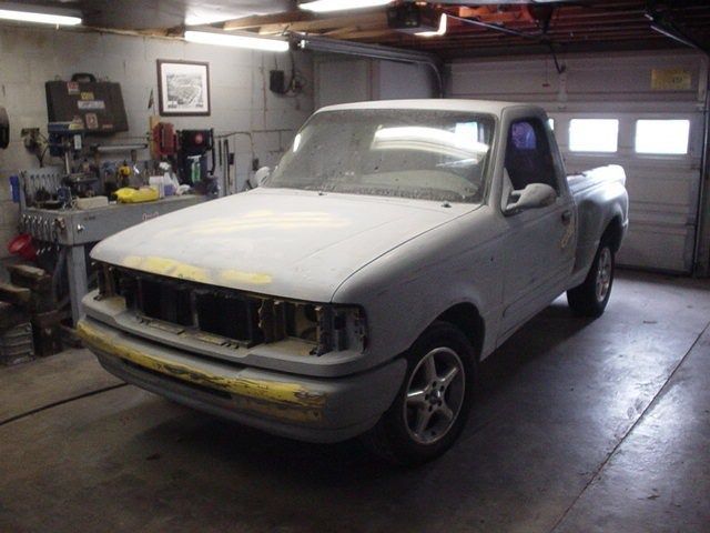

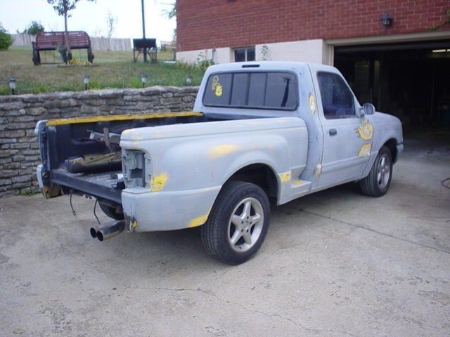

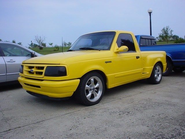

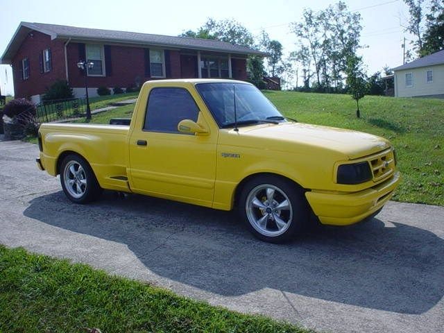

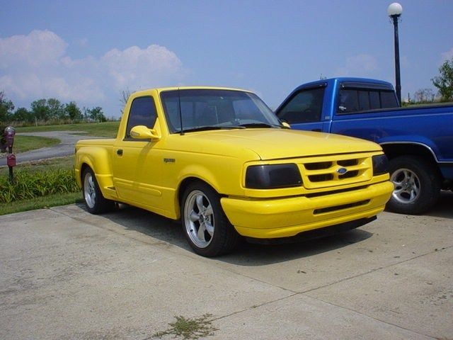

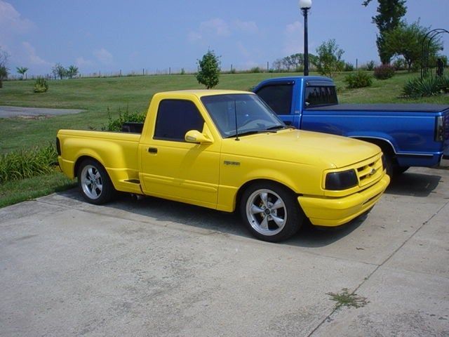

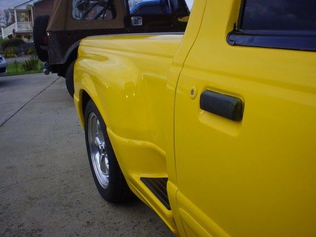

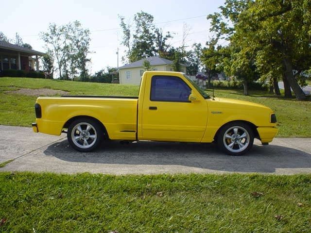

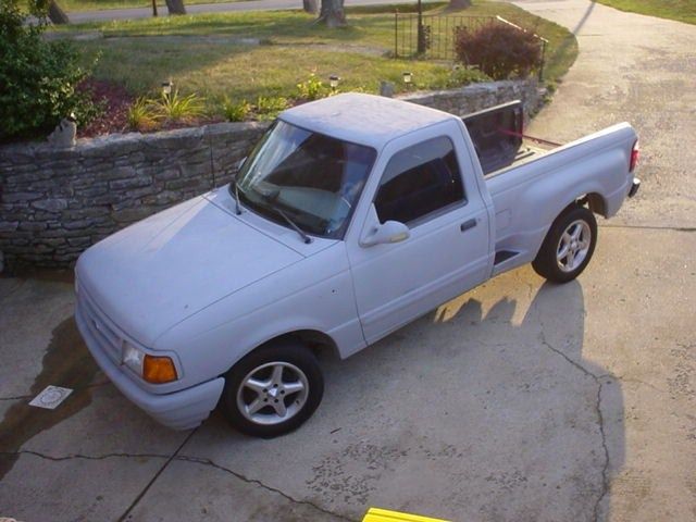

I painted my truck with a roller. datboychevy go to my forum www.rolledon.com there are a couple of guys on there that spray rustoleum.
Here's my ranger. I have about $30 in it.
These pictures were taken about 9 months after I painted it. I've only buffed and waxed it one time after I painted it. I only keep it washed about once a month. Still looks like it did the day I painted it.
