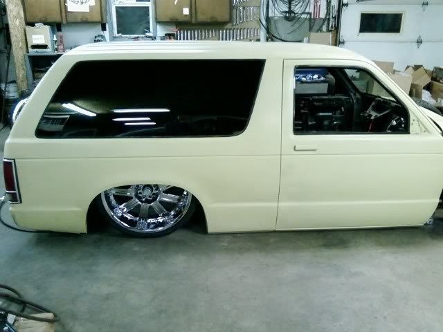

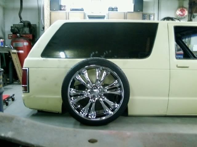

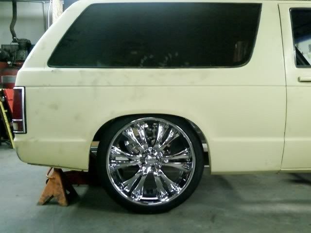

Thanks bro......GREATLY appreciated. I went over the top for the rear. 22x10 with a 4" backspacing. I narrowed the rear a total of 19.5" MONSTER Lip on a boyd slayer. A couple of pics are up on my profile of the progress. My boy Anthony @ Subculture Fabrication is making it happen.

Yeah...I saw the thread on here. Lookin good. How long till there's a body on it?
syzmtrz
I just brought the body over there to start mock up. What size tire did you run up front?

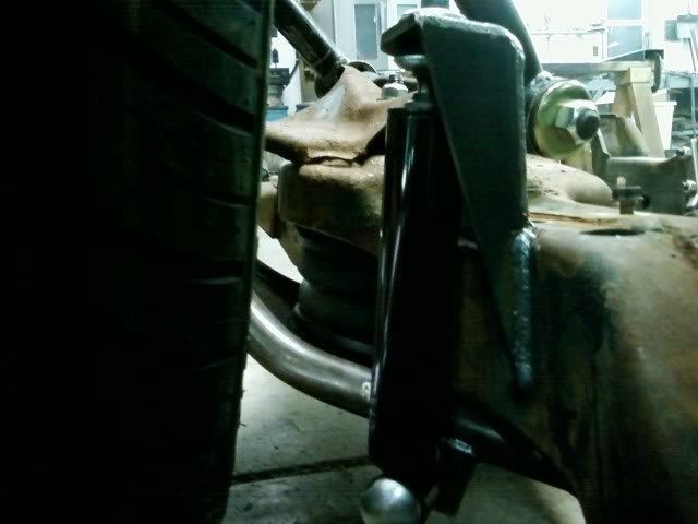

I had 265/35's on my first 22's (22x9 I think) with 2.25" upper bag cups & it laid hard but the tires were too tall to clear the hood and I'm pretty sure they would've been up in to the glass in the rear.
I don't know if they would have cleared a sheet metal (stock) hood but I doubt it. Now I have 255/30's and swapped out the upper bag cups with 3" cups so I'd have the same amount of lift at the same pressure. They still hit the hood. Don't know what I'm going to do about that but the whole front end is glass so I can cut it up quite a bit & get it all back together with little work. It's pretty dramatic on mine because it jacks the whole body line when the tires hit.
