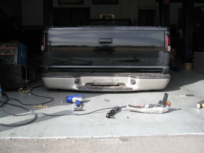

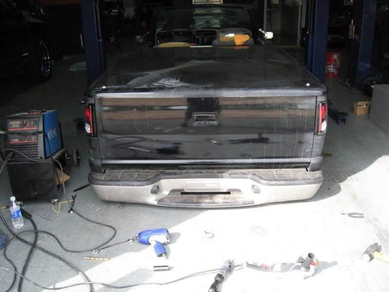

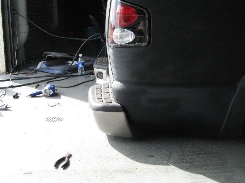

here's some pics i just snapped.. i moved the bumnper in closer to the truck to eliminate that fat gap around the bed corners in the rear.. i'll need to trim some of the plastic top pad so it doesnt sit right on the body....
src="http://i35.photobucket.com/albums/d167/tc02/IMG_1362.jpg" border="0" alt="Photobucket">
i think it turned out pretty dope for a quick job... plus it's a little different since it seems 95% of bd'd trucks have roll pans or skins on them..
what do u guys think?
