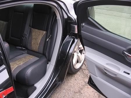

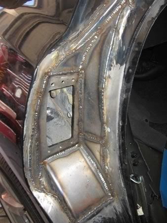

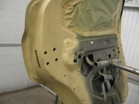

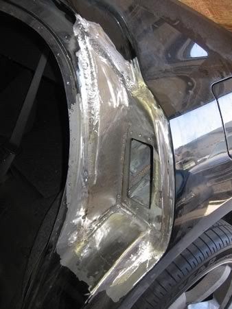

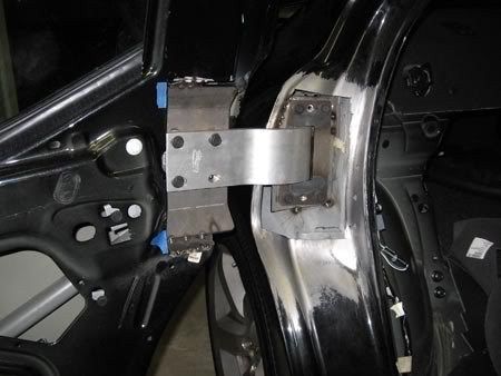

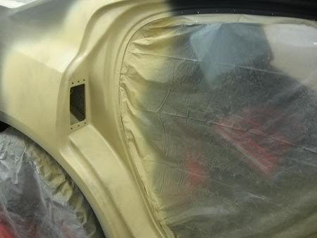

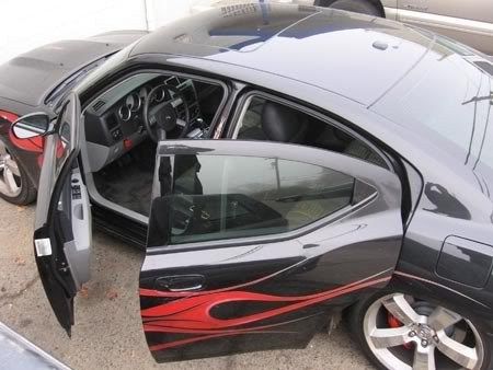

Here's some pics of a set we did on a charger. we used the streetdreamsbyross hinges. they're a bit pricy, but they look and work great with the added bonus of them being hollow so you can run your wiring through them.

^^ That looks awesome on the Charger, nice to see an SRT-8 cut up.

Thanks for the info guys! I love that single hinge setup... just not the $1000. price tag!

hows that single hinge hold up seems like it would sag over time
