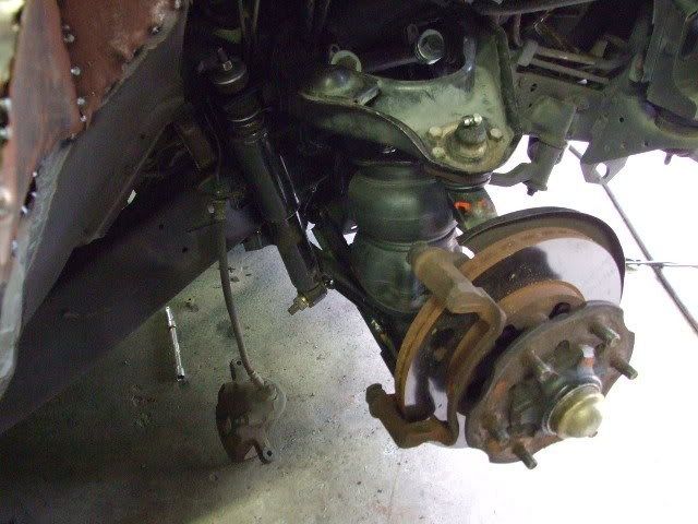

end up lookn something like this an i can lay a 22 and turn im currently on a 245 35 20 when i go to 22s (when i have money) it will be a 245 30 22 check out pix of my page i lay full frame front to back an i have no drop spindles but i do have mautofied lowers got rid of the radius arm an have my new radius arm behind the lca an you can see my shock attached to it

thats crazy looking, and alot of negative camber
