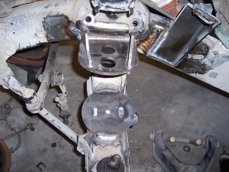

i know dumb question, but with the torsion bars do u remove them and bag the front or do u have to add more to it

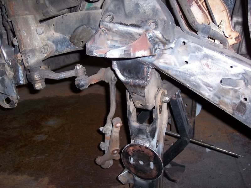

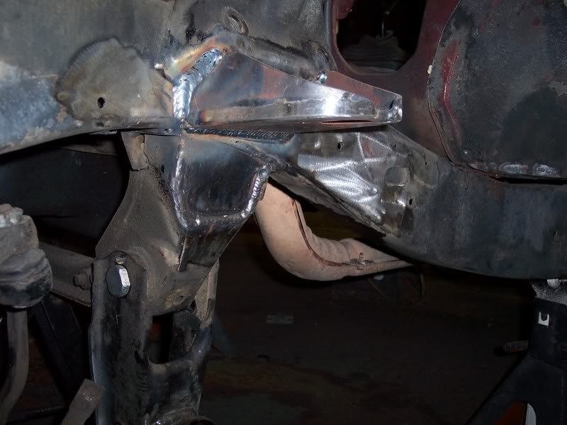

ditch the torsion bars!!you do have to keep your radius bars though...if your just bagging the front. cut the bumpstops down and cap and weld in the brackets...heres couple of dif nissans brackets we welded or made .. http://img.photobucket.com/albums/v333/doctor_iceman/Matt%201997%20nissan%20Hardbody/100_1694.jpgand another one...
hope that helps some..

Looks great Ice. I sure do dislike stock hardbody exhaust, that last pic reminded me. lol
