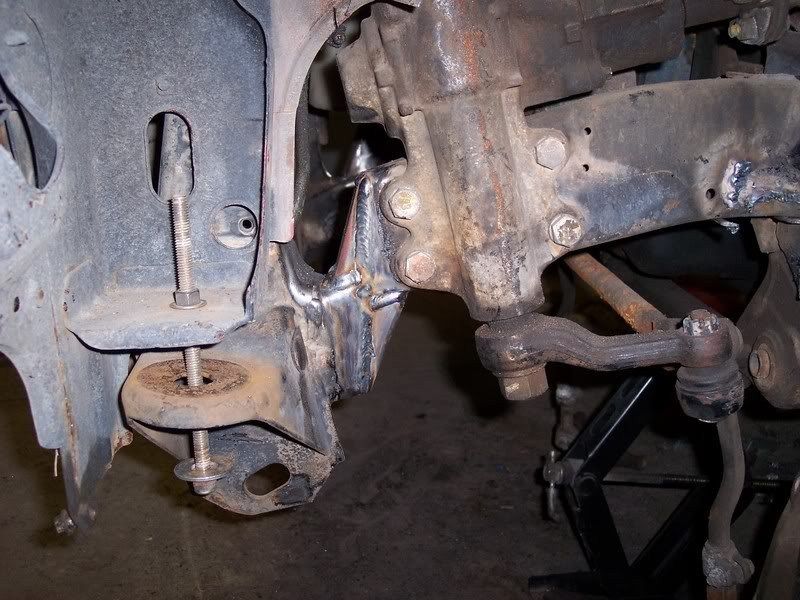

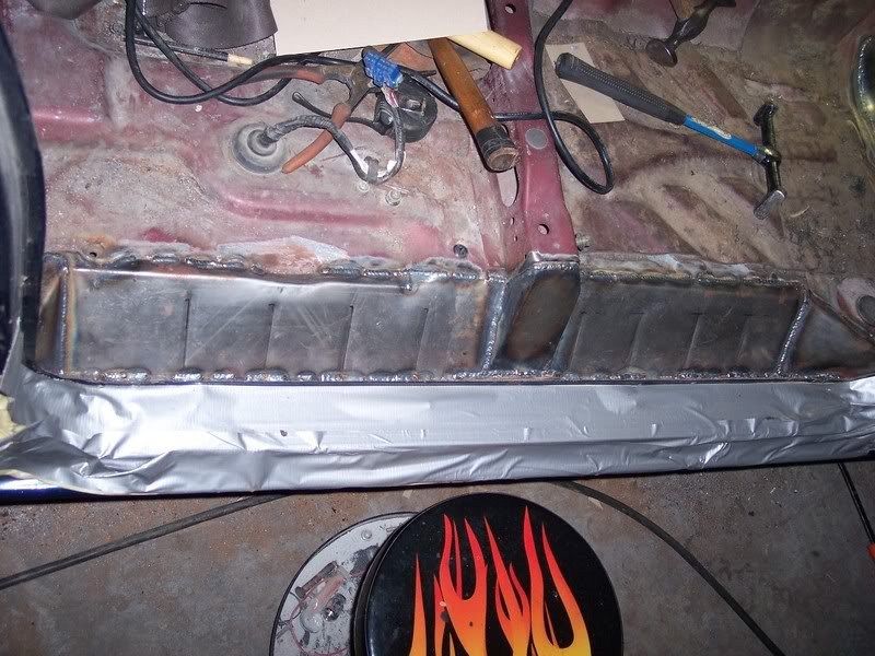

heres a hardbody we're currently working on, maybe help out some on pics..?

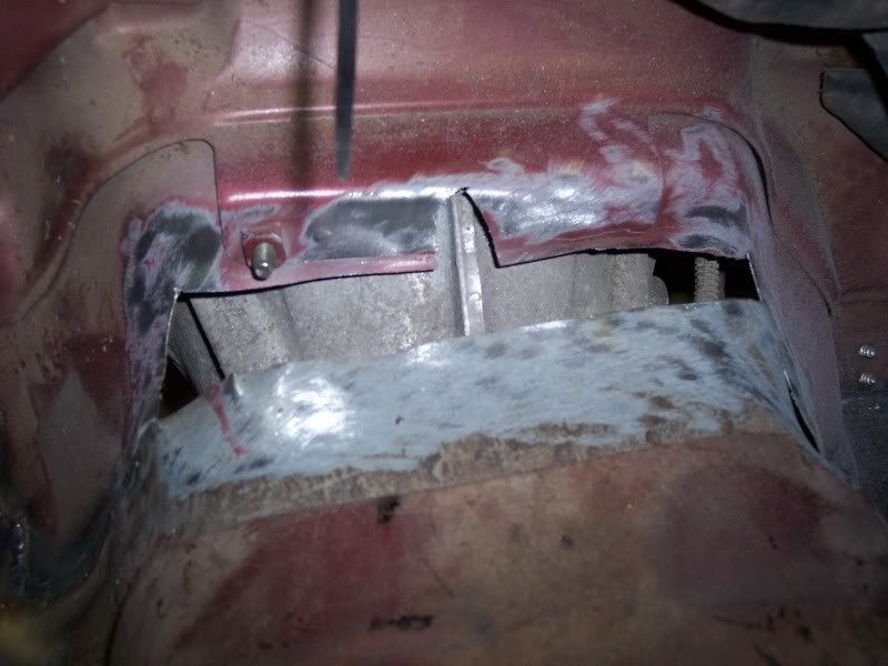

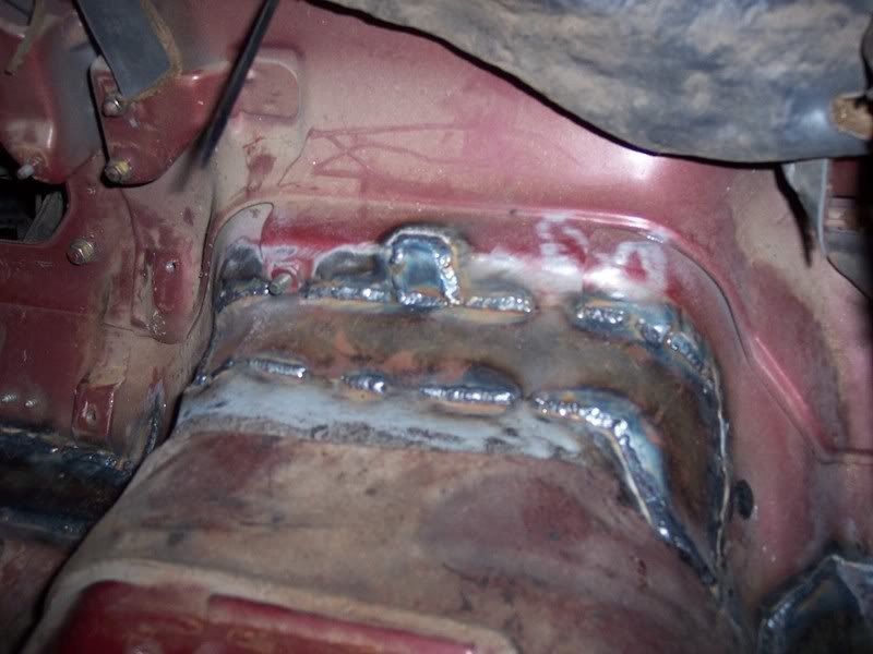

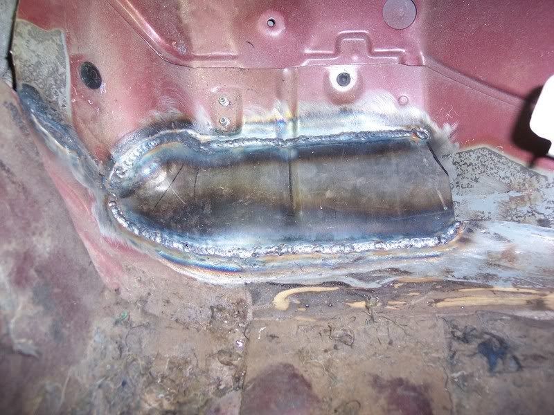

this what im talking about on the tranny tunnel..

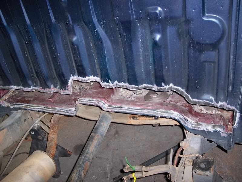

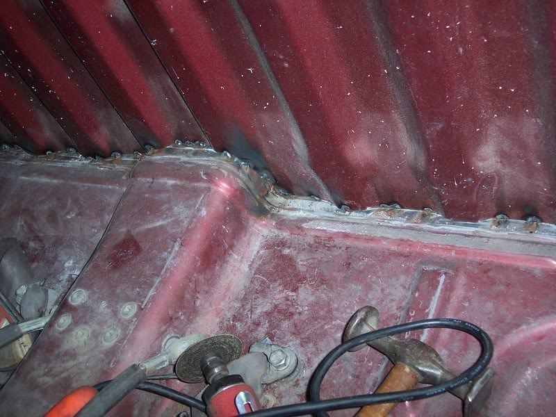

heres other pics for reference.... nothing we're doing is law... just giving ya some help..
