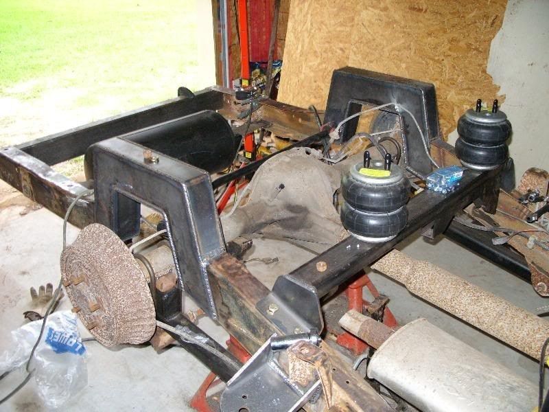

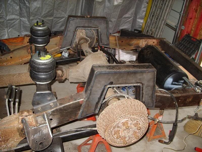

i need to see some pix for a two link i have done triangulated 4 links and parallel 4 links never done 2 two lnk i know i need a panhard bar but what keeps the axle from spining
minitrucker04
on a 2 link it bolts to the axle, kinda like leaf springs. i hope theses pics help u out!
dragyota's avatar
dragyota
well on a 2 link u dont use tabs on the rearend u weld thebar under the rear or u can make it bolt on and the link bar goes in place of the springs or lowering block if thats easier to imagine but i have had 3 now i love them on a daily no troubles always adjusted and on my nissan i made it bolt on and if its measured perfect and the metal is think enough u can tighten down and u dont have to have a panhard because with it being bolted in blace as long as ur bushing are stiff and bolted down super tight then it has noway of moving side to side or u can look at devious style 2 link or ekstensives old one instead of a panhard bar once the rear was in place with the 2 trailing bars u can weld a bar or plate from one bar to the other under the rearend only and it willnot move in any position besides up and down no side to side a little one but nothing big only what the bushings will allow i hope this helps

nothing is wrong with a 2 link. Do yours how you want it. Most duallys and tow pigs that are bagged probably have one, just those people don't have the balls to admit it. As long as it's done correctly and you don't plan on having mass travel, it can be done and can be done right and can work properly.

hey thanks a lot guys for the help im going to use my burb for a tow pig so that will work out great

i have a 2 link on my ranger...was on there for the bags, and now for the hydros...lifts great(bodydropped and it lifts over stock height with the 8 inch hydros). I don't have any great pics of the setup but you can kind of see how it is in my profile. Oh i bought the 2link from silver star customs...
