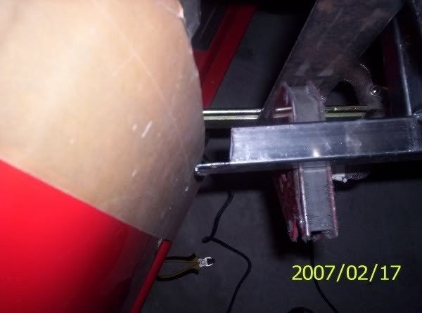

ok, i got one for the fabricators, when I did my suicide doors, i needed to make ensure that the door wont hit the panel behind it when opened. so I welded to 1x1 together like a "T" and cut out one end to mirror the doors edge and used a magnet and stuck it to the verticle piece of flat stock that was clamped to the top and bottom hinge. Also, i did the doors by myself so I built a door holder to use with the floor jack when it came time to move it around..>) Enjoy
