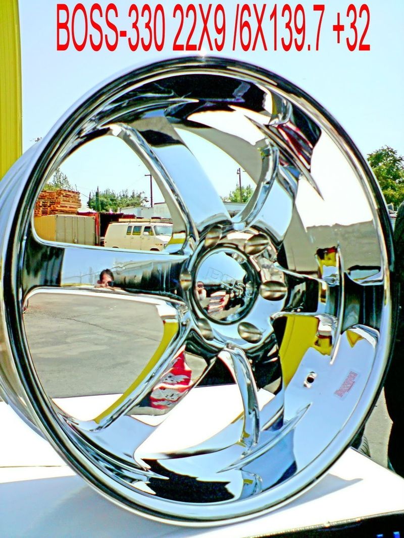

what offset is everyone running on a 22x9 ?
I know im gonna have to narrow the rear end but what about up front?
bigjon's avatar
bigjon
These are the wheels i would like to run
