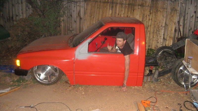

i only needed a 4 inch trad BD t oget on my doors

um, we bd josh's 3.5 to flat rocker and the door is still 2.25 off the ground? i dunno man.

well maybe there is somthing tricky about my pup that i seem to not know about just saying i did a 4 inch bodydrop and i lay doors.

i went with a 6" body drop to get to the doors. i had a 92 model doored way back in 1997 than was light blue primered with centerline 17's on it. seems like yesterday!! damn im getting old. later, brian
