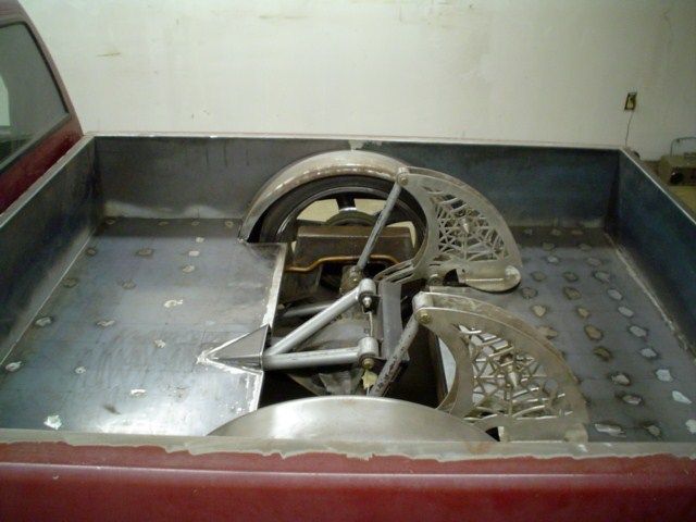

on the topic i found this pic and what is the advantages of this i guess pros and cons.. it just seems like a lot of work and a lot more to go wrong (week points)?

No offense to the owner of this truck, but it is simply crazy for the sake of crazy. There is no reason to build something like this and I guarantee that it ends up being more of a hassle than it was worth.
pootytang
maybe i'm missing something but what keeps that bag from flexing to the side?

I'm not saying that all cantilever systems are unnecessary or going to be a problem, I was just commenting on the posted pic.

they have more pics of thatr truck on here Resolutions 2008 on the sow coverage above on the left
