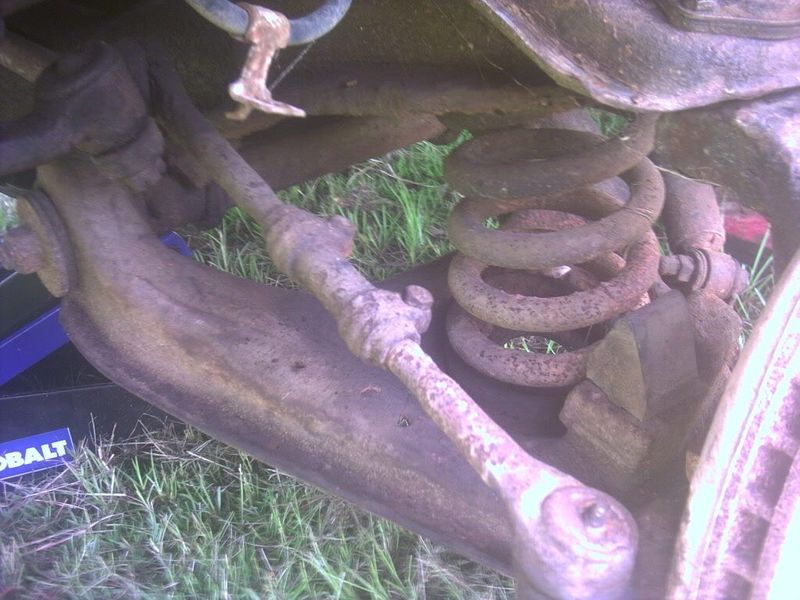

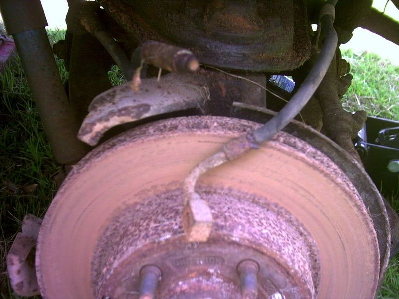

what are these disc brakes off of cause they are on a 64 c10
cdndragrr
looks like 73-87 c-10 to me
AiredOut's avatar
AiredOut

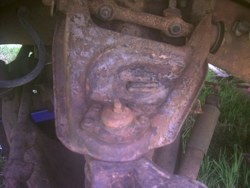

I believe you are right, im pretty sure the whole suspension is 73-87 chevy, but its hard to tell from the pics. Get some better pics of the arms and i would be able to tell you.
bodydropped's avatar
bodydropped
73-87 was the common disc brake swap on the 62up trucks the whole frt x memeber would bolt up if you drilled 2 holes, but those look like calipers off a 73up

the arms and everything but the spindles and rotors are newer
tuckinlugs06's avatar
tuckinlugs06
ok took some more pics also found out it has 2 dif brake lines one you can tell was from the drums and the other frome i guess what ever the brakes came off of...also what bag brackets would i need or could i make some cups for it
tuckinlugs06
or can the spring cup be cut off and brakets made like a torson style truck?
