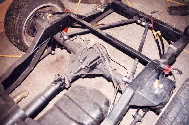

Here is a truck I built back in 1999, It was a 1996 Ranger. Reverse 4 link.

granth
thats a reverse 4....while it works, its not the best option. but one of the easier to use with keeping the tank in the stock position. lotta people on here will tell you just how easy it is to move the tank behind the axle. just a few lines and wires to extend.
Cardcaddy's avatar
Cardcaddy
The best method for that style ranger is to get the rear tank from a 1988 ranger. That method by far looks the best.
