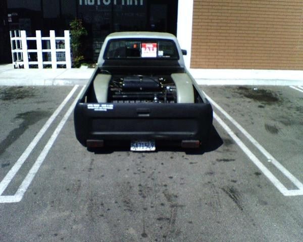

yrs ago this was a factory tailgate welded up, i just reworked it alot for this outcome, but it did start as a welded tailgate.
TwistedPhil's avatar
TwistedPhil
^^^ THAT'S DOPE.

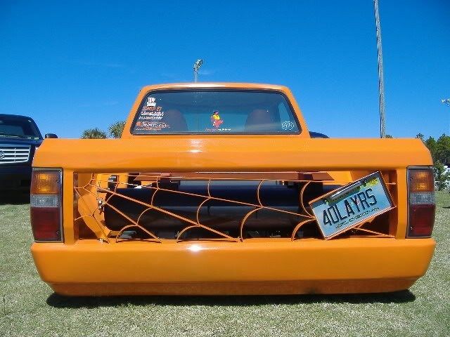

Heres my old bed, put some steel rod between the tilgate and rollpan gap, it came out pretty good.
