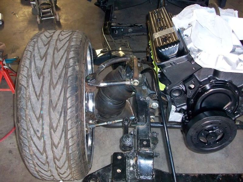

well i got my motor siting in the frame. built motor mounts and fab'd some brackets up. its just rough right now. nothing is ground'd or finished yet. but enjoy seeing a 350 sb and turbo350 tranny in a z'd and narrowed mazda on 24's.
got room for headers? going to be makeing 100% custom headers that go up then back down at the rear of the block.
the reason the control arm is different on this side is so the steering will bolt back up and the control arm will miss it. its no done yet i need to get the headers fabd so i know where i can plate and where i cant.
nice and tight. just how i like it. haha. the top of the tires are where the hood is. plenty of room for a 650cfm carb and custom ram air intake. the tranny isnt mine. i have a built one that will be going in. just isnt done yet.
plenty of lift with 120psi in the bags. tires are untucked by about 2 inchs. balljoints are locked out.

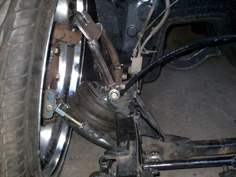

kinda see how my steering is setup now. im going to be upgrading to one size bigger heims i think. i still get awsome turning radius to. i swaped to 01+silverado spindles. all dom tubing and 1/4 inch plate. upper s10 balljoints and lowers are upper chevy 3500 van ball joints. found the instant center to know where to set my steering up at. im going to plate the uppers a little more. but after i get my headers built.
got some lift? gets about 16 inchs of travel.

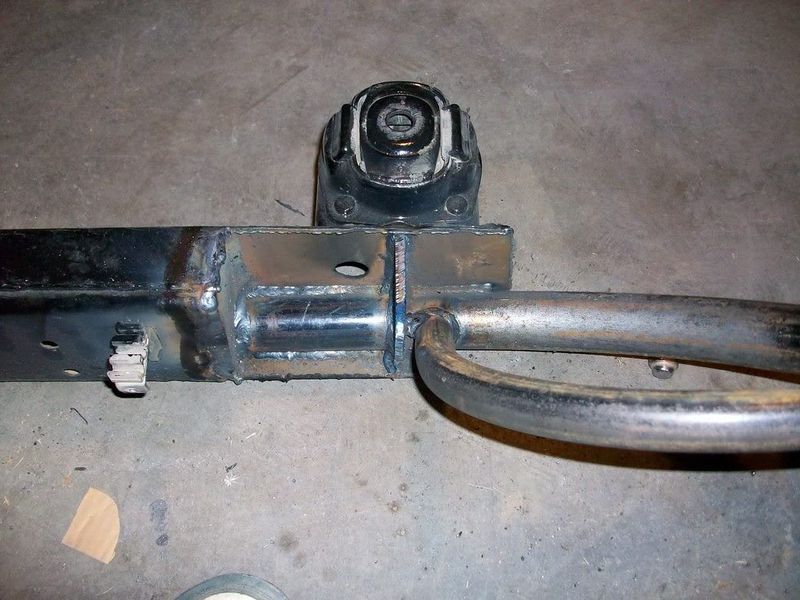

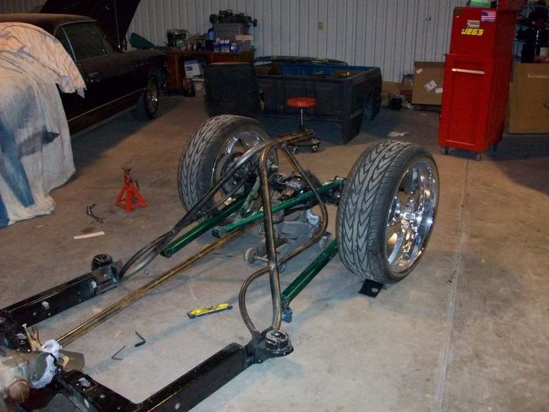

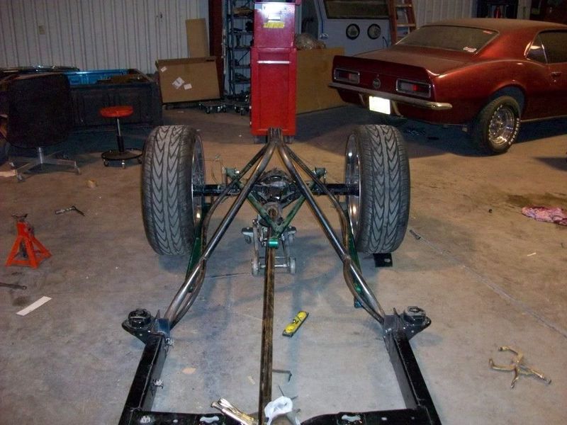

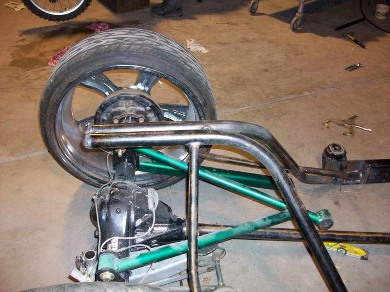

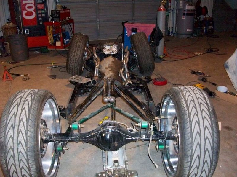

got some new updates.
what ya think? i think its came out awsome.

fatboysS1O's avatar
fatboysS1O
i wanna see what the rear setup looks like done and on the truck. not saying i dont like it, just i cant wrap my head around the look of the rear.
