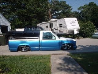

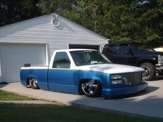

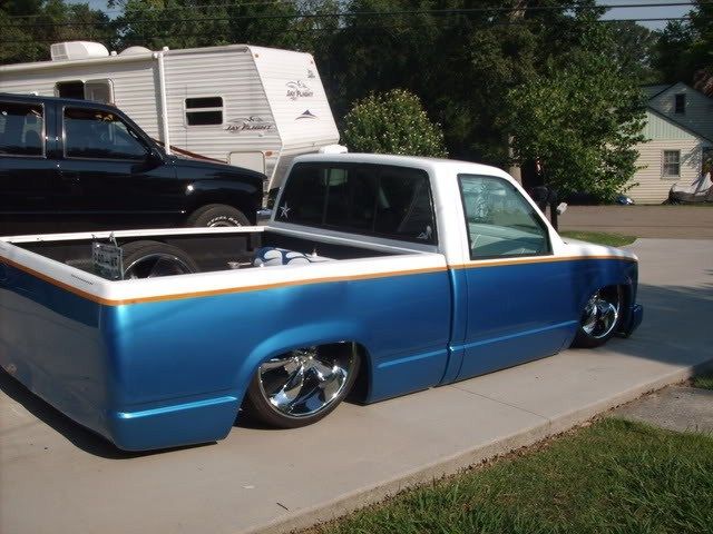

first of all, no offense, but your grammar is horrible. second, i dont have steering problems and u have to do everything as if u were bodying on 20's or 22's....just bigger, about well, 4 inches bigger. and as far as what is best, thats ur preferance. mine is traditional and i love it. i could build a frame but dont really have the time or space cause i drive it every single day. good luck and u seem unsure so research like he!!. heres some pics for reference and lets see yours.

/\ did you narrow your axle at all, or just bubble the bed??
aaron
bubbled? lol, i kinda consider it a little flare, bubble sounds wierd. but i did it by cutting out the sides and hammering out metal on the sandbag till it fit. it only hit on the driver side cause of the panhard. i thought about narrowing but id have to ditch the 6 link pretty much and i cant afford new stuff and id have to do a lot of relocating under the bed.
