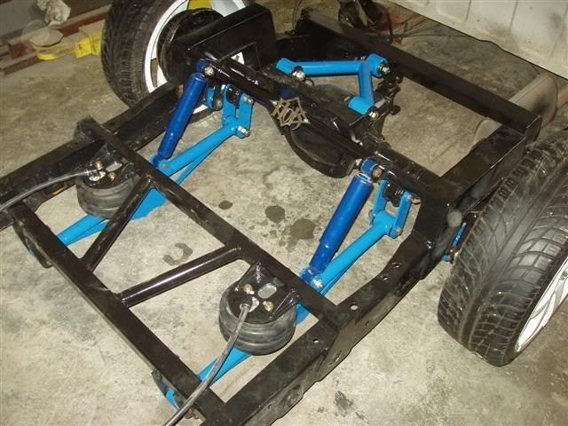

mindlissmetalfab's avatar
mindlissmetalfab
Not sure if you are already planning to or not, but you cant just flip the 2 link bars around, since they are solid mounted to your axle. You will need to have a bar end on the axle side of the rear bar, and then some sort of shackle that will attach to another bar end soilid mounted to the axle. I've done a couple trucks like that. it works well. This is one I did on an s10. Its an SD 3 link then I added the 2 rear lift bars. Gives you a good idea of how you need to link the bag bars to the axle.
