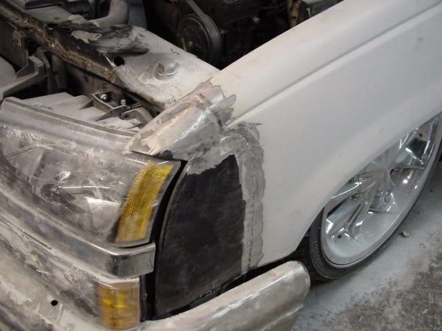

20x8.5 NEED +30 TO TUCK GOOD AND TURN VERY LITTLE MY BUDDY HAS +35 ON A 20X8.5SORRY BUT IT WAS THE BEST PICT I HAD AT THE MOMENT
