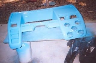

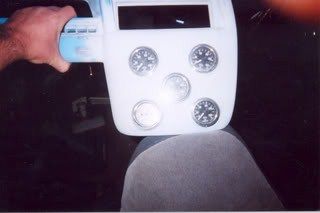

exotic dreams
I used pvc pipe. Here is an example; i used cardboard to get the angle using resin as glue. Then just lay chopped matt until you get the thickness. I prefer using epoxy resin for plastics
