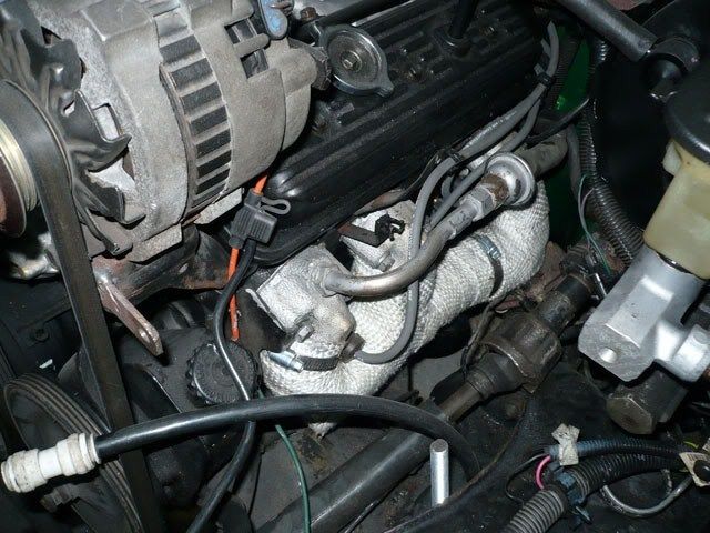

I think i notched the frame for the shaft as well the more I think about it. It has been a while.
But yes, the steering shaft will fall with the truck. If you wanted to get tricky, you could relocate the column mount on the firewall higher, and its really easy to section some length out of GM columns. But you should be fine just notching the UCA and frame.
only picture I have of said area.
datboychevy
thanks, dosnt look like too much of a hassle. its easier for me to notch some metal than to section a column.... uve helped me a ton....
